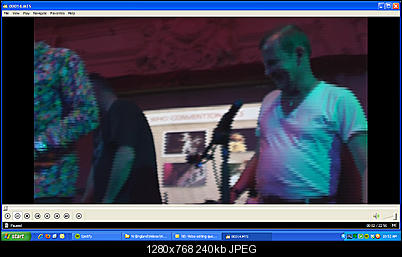

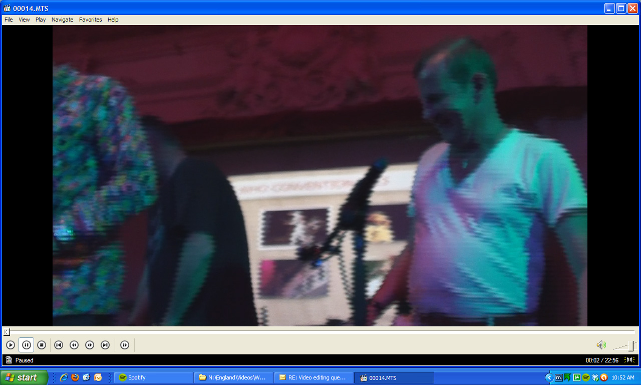

    Trying to work on this video for a friend and I'm not sure exactly what all is wrong with it. I'm just looking for the problems and what may have caused them and, if possible anything that can be done for it. This is from a raw files that was shot using a British camcorder that records to a data chip and playing on computer:

  2. The video is interlaced. You need to use interlace aware filtering. Or deinterlace before using non-interlace aware filters. If the video was screwed up before you got it there's nothing you can do. It would be best if you posted a short, non-rencoded sample.

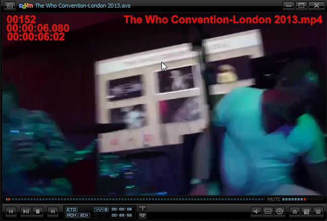

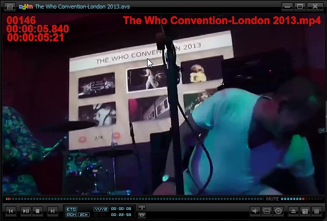

  6. I think Youtube does a blend deinterlace. That will look like double exposures when there is significant motion. Deinterlacing with Yadif before uploading to Youtube may give better results.

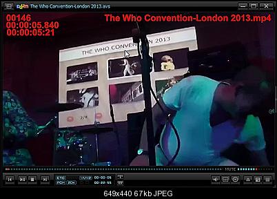

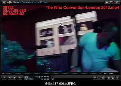

  7. Member Budman1's Avatar
    Jul 2012
    NORTHWEST ILLINOIS, USA
    Yes, I see what you are saying There is considerable double exposure or at least blurring during movement:
Name:	ScreenHunter_27 Sep. 20 17.45.jpg
    As compared to no motion:
Name:	ScreenHunter_27 Sep. 20 17.46.jpg
    Ill tell the owner of the video.
