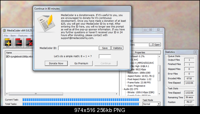

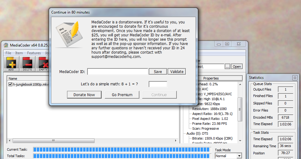

    with 36 seconds to go in an hour long encode Mediacoder pops up an demands money to continue. F*** them. Off my list of recommended encoders and off my computer forever. Others that are just as good.
