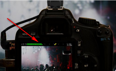

    you need to set the gain in the camera so that the mic levels peak just below 0db. i use magic lantern firmware in my canon so that i can have the levels display on-screen and adjust the levels on the fly while recording video.
  3. How about if I use Canon's EOS utility to check the sound levels. But how do I change the gain ? Is it by going to sound recording, the choosing manual to get the record level and then increase the record level? Is that the way? or using magic lantern?
