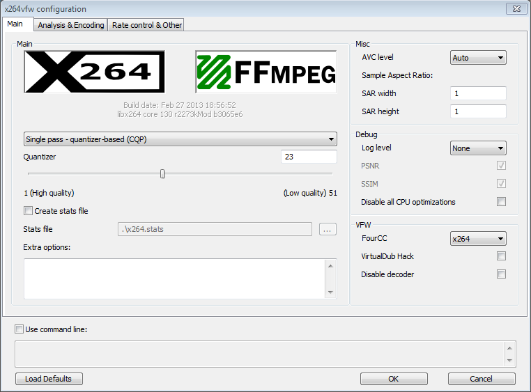

Here are my current codec settings:
Is there something obvious I should change? Thanks for reading and looking at my problem.

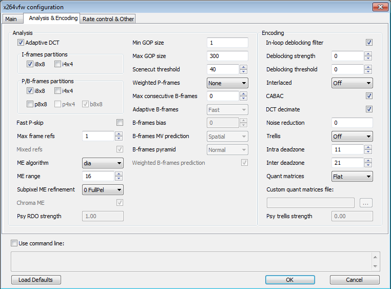

The biggest detrimental factors for editing performance (decoding latency ) are large GOP size, cabac, and deblocking
So you could reduce the GOP size (change max GOP size to something much smaller than 300, maybe 30 or so) , disable cabac and deblocking
But those changes will impair the compression - you will need larger filesizes for the same level of quality . You can think of it as being less compressed and easier to decode . In general, the more compressed a video, the harder it is to edit smoothly -
This is exactly why I ask, you have knowledge I don't. Thanks for the advice. I will try in a few hours when I get back home.
If it's still too "sluggish" , reduce the GOP size even more, until it's down to 1 . It's going to depend also on your hardware specs
People tend to use intra (I frames only) for intermediates, and usually lossless. You're recording with very compressed end delivery settings, not typical capture settings . Another reason is you're going to lose more quality when you export the final video after editing. People like to preserve as much quality as possible until the end
So you're going to have to make some compromises if you intend to stick with small filesizes for capture
