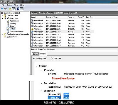

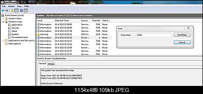

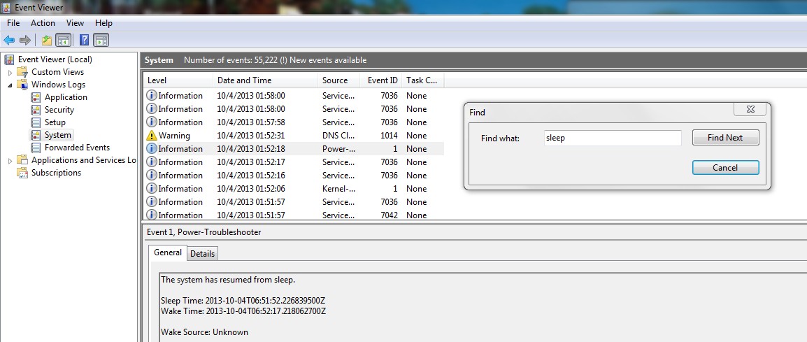

    I just had an occurrence as you mentioned on my computer and I used this to find the source. Look in the system event log (Start->control Panel->System and Security->Admin tools->event viewer). Expand windows logs and select system. Hit CTRL-F to bring up find window and look for sleep:
Name:	ScreenHunter_34 Oct. 04 11.33.jpg

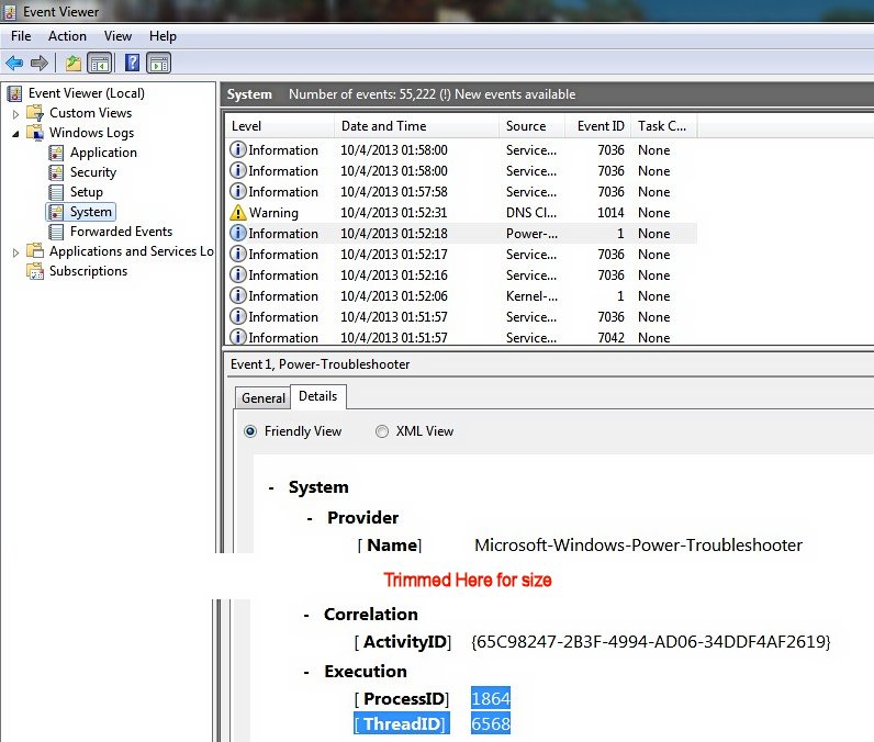

    Click the details tab and expand System plus sign to find Process ID:
Name:	ScreenHunter_34 Oct. 04 11.34.jpg

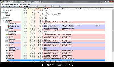

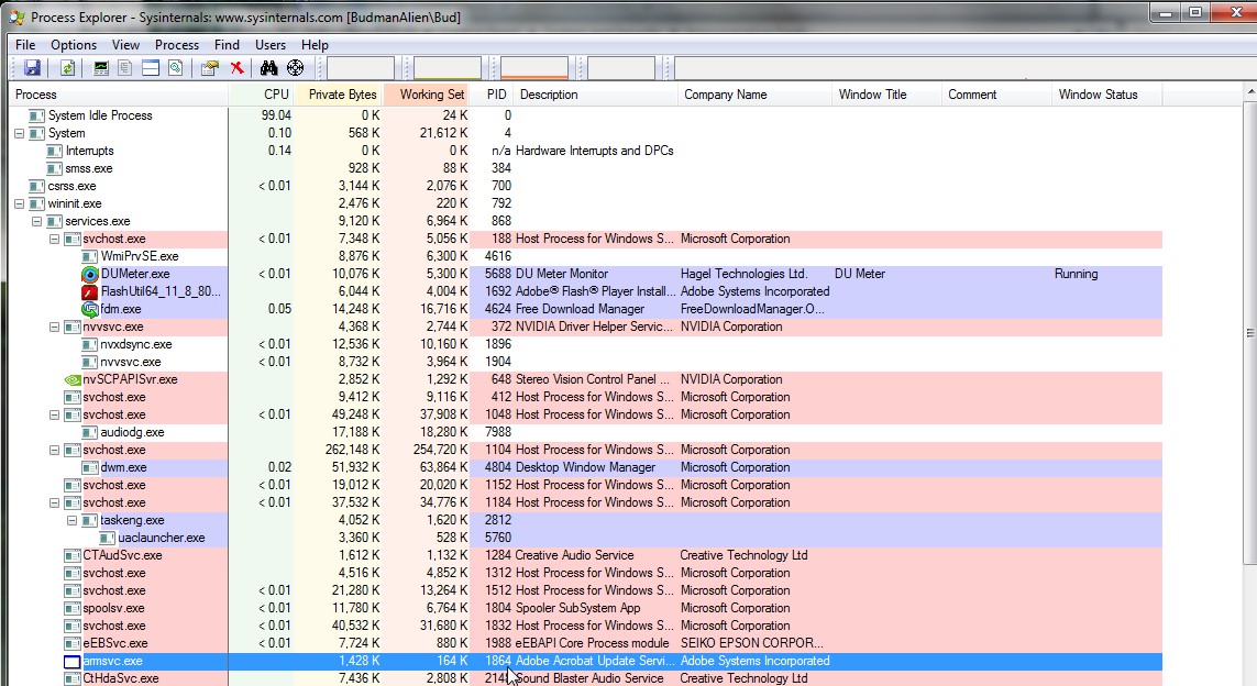

    Downloaded and opened Process Explorer to find Process ID:
Name:	ScreenHunter_34 Oct. 04 11.35.jpg
    Turns out it was Adobe updating so I turned off the ability to wake the computer as mentioned in the thread from themaster1.
