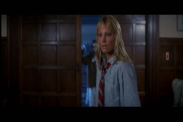

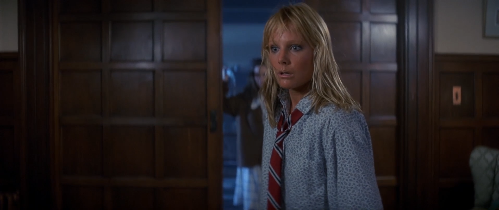

    Hey all,
    It's been a while since I had any idea how to do these things so I could use some help.
    Attached are two shots, a SD (720x480) and an HD (1916x808). Can someone please look them over and advise how to properly blow up the SD one to match the HD shot?
    I'd imagine cropping would be involved but yeah, I don't know.
    - J

    How were the captures made? How did you get the original source video onto your computer? What is the frame rate of the original source? Was it taken from a DVD? A little short on info here.
    IF this is a Hollywood movie, note that Hollywood doesn't make movies in a 16:9 aspect ratio. In n ay case, 1916x808 is non-compliant for BD or AVCHD disc and, further, you will not be satisfied with SD source resized to a more 1920x1080 -- which a 16:9 frame that does not accurately reflect the correct aspect ratio for a 1.85:1 or 2.35:1 Hollywood movie.

  3. You can get close simply by cropping the top and bottom black borders and resizing what's left to 1916x808. If you need more perfect results than that you'll have to spend a lot of time working out the details.

    The SD and HD captures were both "copy output frame to clipboard" in VDubMod. The SD taken straight from the DVD's VOB. The HD version is an iTunes rip; no re-encoding... I used Requiem to directly strip the DRM. I then pasted them into Photoshop and saved as a bitmap. The HD version really is 1916x808, which makes me think they kind of "pre-cropped" it for streaming...? The DVD's frame-rate: 23.976. The HD frame-rate is the same. I didn't resize anything.
    Jagabo:
    The problem with cropping the top/bottom is that I can't seem to pinpoint where the borders truly end and the picture data begins. Even if zoomed in to an outrageous degree, the borders seem to melt into the picture :/
  5. You can start by using the same frame (these aren't the same frame)
    It looks slightly warped, so it will be difficult to match perfectly

  8. If we assume there was no camera motion between those frames, and you only want to get a "close" match; in RGB mode (you can't crop by non even numbers in YV12) :
    Crop(1,55,-1,-60)
    Spline36Resize(1916,808)
  9. Originally Posted by takearushfan View Post
