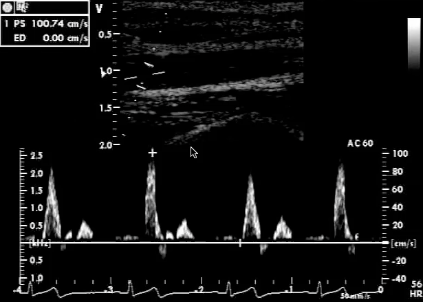

    I video files that have an voltage input line running along the bottom of the screen, and video taking up the majority of the screen.
    What i need is either to grab frames when the voltage spikes / or to drop the frames immediately following the spike.
    There are frame grabber cards that will do this, but we have some (a lot) of older captured video that needs to be processed. Now I could go through frame by frame and click "grab frame" in VLC for example, but each file is ~16 thousand frames, so I am hoping there is a way to automate the process.

  3. Hi Thanks for the reply, that sounds possible as my video files are monochrome so dropping frames when a certain area is white may be possible.
    Ive got a short video loop that might help, but not sure how to upload but I have a screen shot .
    What I need is to remove the frames (approx 15 frames) immediately following each pulse so that the pressure twitch of the vessel at the top is removed. Or to put it simply, I need to edit the file so I only get the frames between each spike!

    Let me see if I understand the picture you uploaded. The lower third (not the very bottom) shows four major spikes (and some minor spikes). The spikes enter from the right of the frame and scroll to the left. At the top of the frame is an image (ultrasound?) that corresponds to the spikes current entering at the right. You want to keep frames when a spike appears at the right edge. You want to discard frames where there is no spike at the right edge. Is that right?
  5. Hi Thanks for the response, you almost correct. The spikes sweep across the screen and I want to delete the frames where there are spikes (and shortly after each spike) and only keep the frames leasing up to each spike. We measure the width of the vessel at the top, and the spikes make the vessel pulse and appear wider than usual, which is what Im trying to edit out.
    The lower spikes are an ECG and the upper bigger spikes are doppler flow signals (yep its an ultrasound study)
    I have attached a video file (hopefully) but this is a quick screen cap so ignore frame rates / file types etc.
    I looked at avisynth, and it looks promising, unfortunately I code like brick floats....
  6. That clip has many duplicate frames (and not in a perfectly regular pattern) that makes detecting the differences between frames more difficult. It's also got some other oddities -- like it's interlaced video encoded progressively, variable frame rate, etc. Do you have something closer to the original?
    In any case, here's the first part of the process, detecting when the peaks occur. At the bottom of the video are just the major peaks of the ECG (blue background) that would be used to determine what frames to eliminate.
    I can see that there's a little swelling during the small peaks too. Do those need to be filtered out? It would just be a matter or increasing the height of the window used to detect the spikes (I intentionally used a window that only includes the taller spikes).

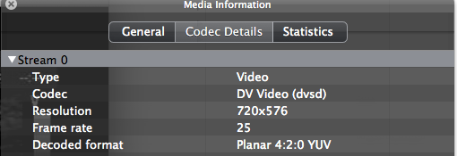

    I havent got a sample to upload yet as they are huge raw digital video captures and I dont have any software to cut a small segment with. VLC codec report is attached. And yes if the box could be bigger to catch the secondary waves that would be ideal.
