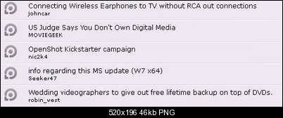

  1. I am working on several projects for which I have to do lots of screen recordings. And I have been experimenting with different screen recording softwares. I have tried ActivePresenter, BBFlash Express, Camstudio and Camtasia Studio. All of them seem to do the recording job really well. But as far as rendering the recorded videos is concerned, I get fuzzy picture and blurry and thick looking text in each render. The only time it didn't happen, was when I recorded a few clips with BBFlash Express' Lossless coded. And rendered it in lossless. But of course the file size was way too big. Then, as soon as I re-encoded the lossless file into an avi, using Format Factory, the same thing happened. The picture and the text in the video became fuzzy.
    I read a lot about rendering on the forums of those softwares. All of them said one common thing that you must record and render with the same settings. In terms of screen size and frame rate etc. If you record with one set of settings, and render with another set of settings, then the video quality would suffer. And I did everything they said. But the problem still remained.
    I have a 19 inches monitor, so my screen resolution is 1280x1024. I wonder if that has anything to do with it. Although, I even tried recording with other lower screen resolutions. But, everything gave me the same result.

  2. Originally Posted by Earthling2000 View Post
    I don't see that in your sample images.

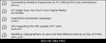

    lossless:
    lossy:
    I see color differenes and DCT ringing in the lossy image. But not blurry or "thick" text.

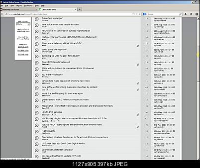

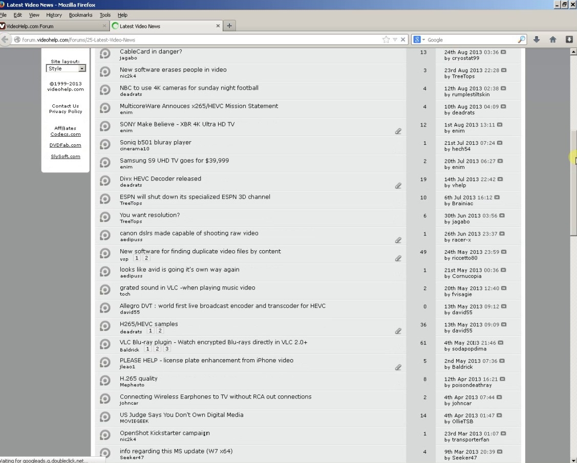

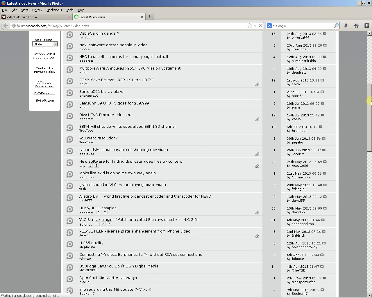

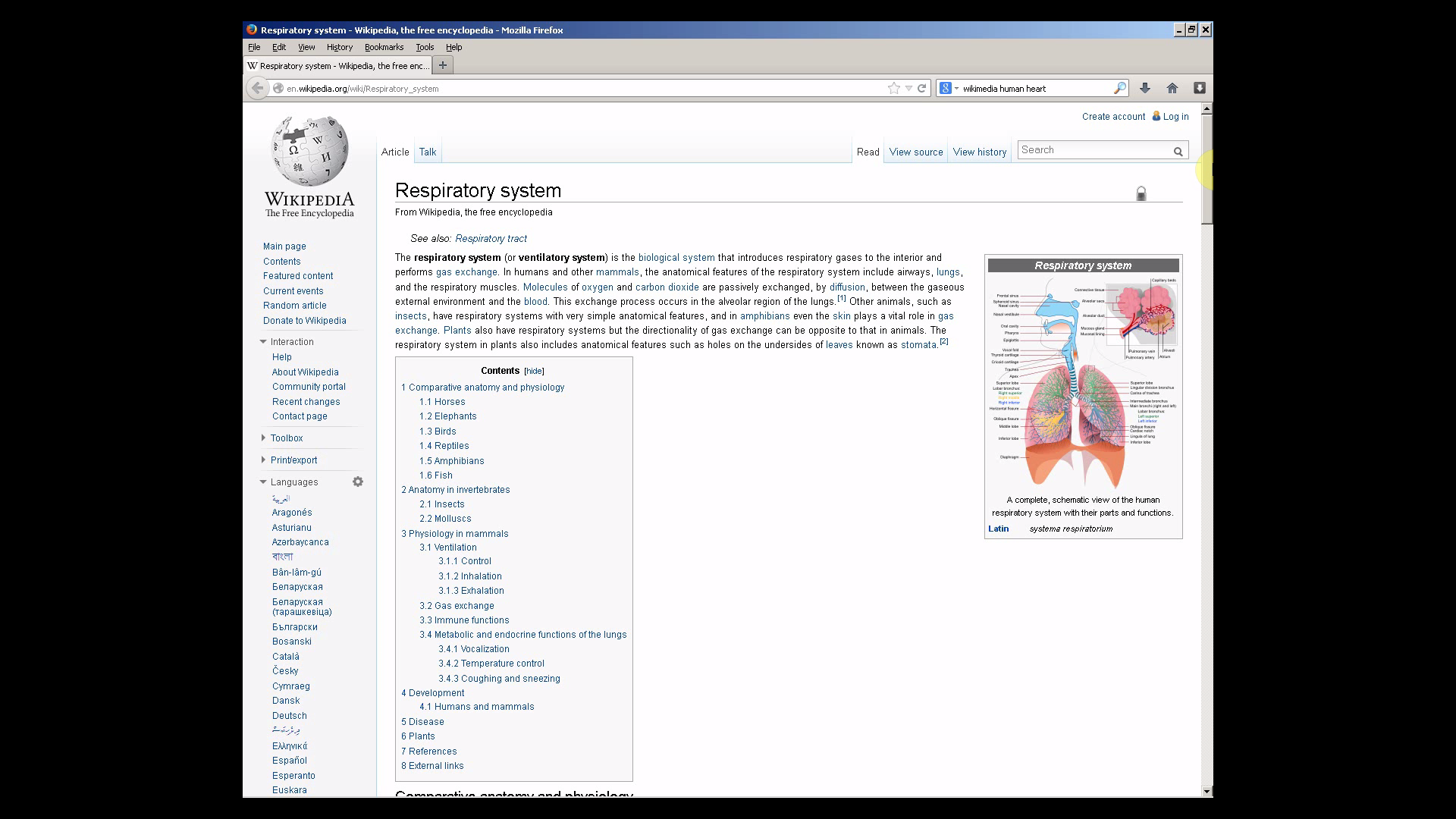

  4. It's strange, but when I played the video in VLC player, the picture was blurry and the text was thick and fuzzy. But when I took snapshots in VLC, they were crystal clear. And yes, in the videos, the text did look thick and fuzzy as when your monitor has the X and Y problem. But it doesn't look that way in the VLC snapshots.
    I'm really confused about what's happening. I just need the videos to be perfect, don't need the snapshots.
    This is how it appears in the actual video.
Name:	In the Video.jpg
    This is how it appears in the VLC Snapshot of the same video.

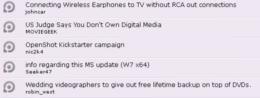

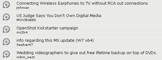

  7. Yes, the problem is the resizing during playback:
    On the top is the VLC Snapshot, on the bottom is the screen capture. The screen cap is obviously smaller. If you set VLC to play full screen you should get the same clarity (assuming your desktop is 1280x1024).

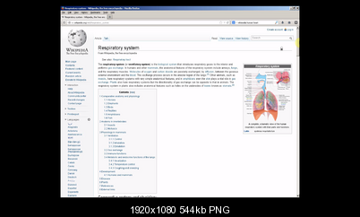

    Earthling2000, there doesn't appear to be anything wrong with the Xvid file. Here's a screen cap of it playing on my 1920x1080 screen with 1:1 pixel mapping:
    You'll have to click on the image a few times to get it to open in its own window with 1:1 mapping on your screen. The black text is perfectly sharp. The color text has fuzzy colors (but sharp luma), as expected, because of the YUV 4:2:0 chroma subsampling used in Xvid.
    So why doesn't it give a nice clean picture when you play it full screen with VLC? Make sure you have the following settings while running full screen: Video -> Zoom -> 1:1 Original, Video -> Aspect Ratio -> Default, Video -> Deinterlace -> Off. That gives me a view like the one above. For you it should fill your 1280x1024 screen with 1:1 pixel mapping. So it should look like the above image without the black borders.
