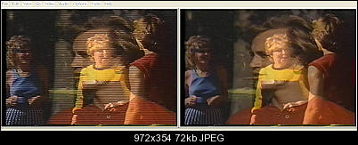

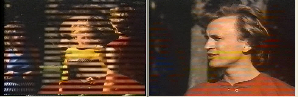

  1. Not sure what the proper term would be, but it is almost like a ghosting (or possibly chroma) like effect I am getting after deinterlacing and only occurs on SOME scene changes (not all of them). It does not matter what deinterlace filter (or even decomb/ivtc) is used. The color effect appears for 1 frame only and always in the same spots.
    my source is 4:3 720x480 mpeg 2 material (dvd). The clip itself is interlaced at a straight 29.97 fps (homedeck recorder route). The actual source was a vhs tape. NTSC
    I am toying with this in virtualdub using the huff codec as output
    For arguments sake, lets just say yes I need to deinterlace the material.
    Is the frame issue I have solvable or is it a case of "that's just the way it is"? I can live with it if need be, but if I can remove it, even better
    sample below- interlaced on the left pane with the deinterlaced artifact on the right
Name:	odd color.jpg
  2. The problem is the chroma channels of interlaced YV12 treated as progressive YV12. Are you opening the MPG file directly in VirtualDub? If so, use Video -> Color Depth... and set Decompression Format to YCbCr 4:2:2 YUY2 (some of the others will work too). If you're using AviSynth ConvertToYUY2(interlaced=true) or ConvertToRGB(interlaced=true) before giving the video to VirtualDub.
  3. Originally Posted by jagabo View Post

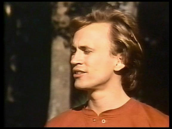

    Thank you Jagabo. Yes i am opening the mpeg directly in VD. I did change the color depth decompression and it sort of worked but now it gives me a red effect, check the pic.
  4. Hey Jagabo

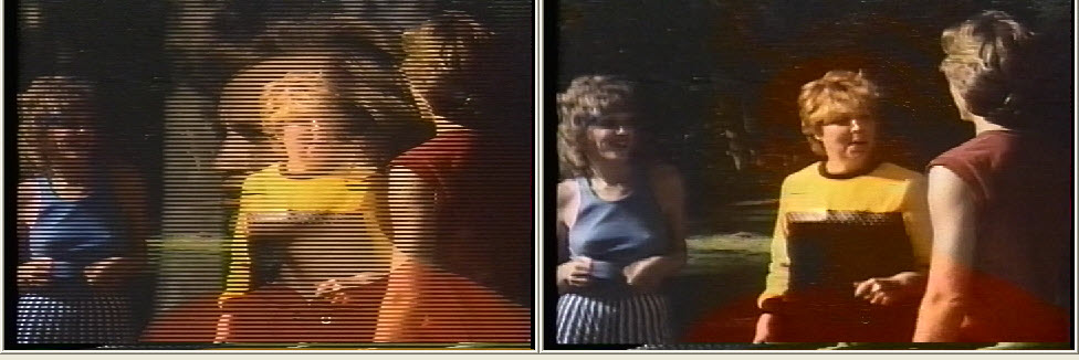

    Looks like I might have got it. I keep the color depth decompress as you suggested, but right in front of my blind face I had also installed it's smart deinterlace 2.58 filter. I set that to blend (since it seems like a slight overlap of the frame blending). Setting it to blend took care of the problem as you can see in the pic below. If this still look wrong to you, please let me know-

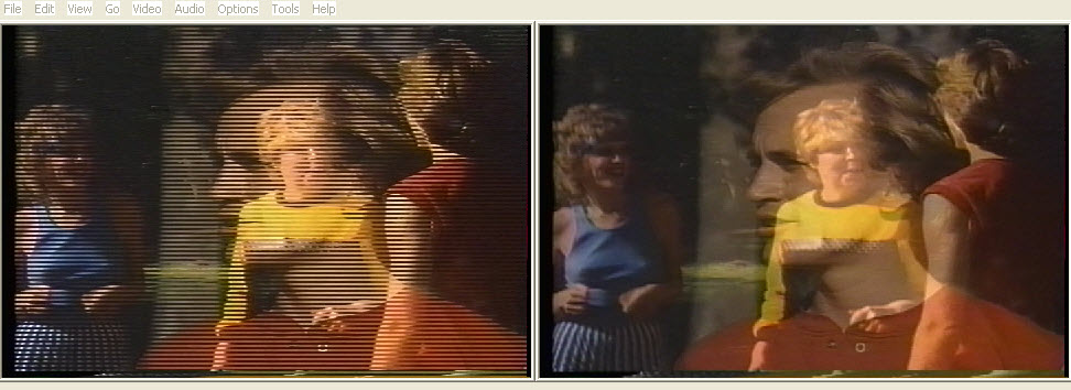

  5. Ok truly solved it. I had a severe crash course with avisynth ( AvsPmod is a godsend!!) and finally getting some long over due options I wanted running. This included getting all the filters needed for QTGMC. I read up on that, but though it did a wonderful job it still gave a duplicate frame. So instead I ran the TFM/TIVTC filter and THAT got it going and did a much better job than the Decomb filter in virtual dub. No crazy colors, no dupe frames and nice smooth motion. My end script looked like this
    LoadvfapiPlugin("C:\Program Files\Womble Multimedia\MPEG Video Wizard DVD 5.0\WbpVFAPI.vfp", "womble")
    womble("C:\Documents and Settings\SOME GUY\Desktop\borders test.wbp")
    FlipVertical
    AssumeTFF()
    ConvertToYv12(interlaced=true)
    TFM().TDecimate()
    crop(18, 0, -8, -12)
    addborders(12, 12, 12, 12)
    In my case I am then putting this script into avs2dvd to skip the entire avi step. Either way your mention of avisynth and what to use in post #2 really made me look into it a bit more and I am glad I did

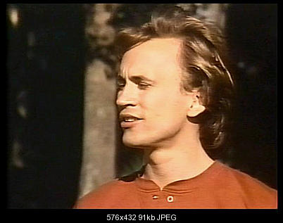

    In my head I was thinking that if I did not keep the convert to=interlace command it would think the clip was progressive to begin with. Since I am just going to be doing an ivtc on it would it be safe to say I can remove the ConvertToYv12(interlaced=true) command from the script?
