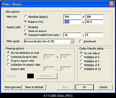

    I have two questions.
    1. Is this the correct way to convert a .avi file from 4:3 to 16:9, using virtualdub, or is there a better way?
    http://tinyurl.com/ljeuw7t

  6. The proper way to make it into 16:9 is to add pillarbox bars. But the player or TV will do that on playback so there's no point in encoding it that way.
    The other "correct" way is to crop 60 lines off the top, 60 lines off the bottom (or an uneven mix adding up to 120 lines) then resize back to 720x480 (for DVD encoding) or to a 16:9 frame size. But that will lose 25 percent of the picture. And the video is interlaced so you'll have to use interlaced resizing which will degrade the picture.
