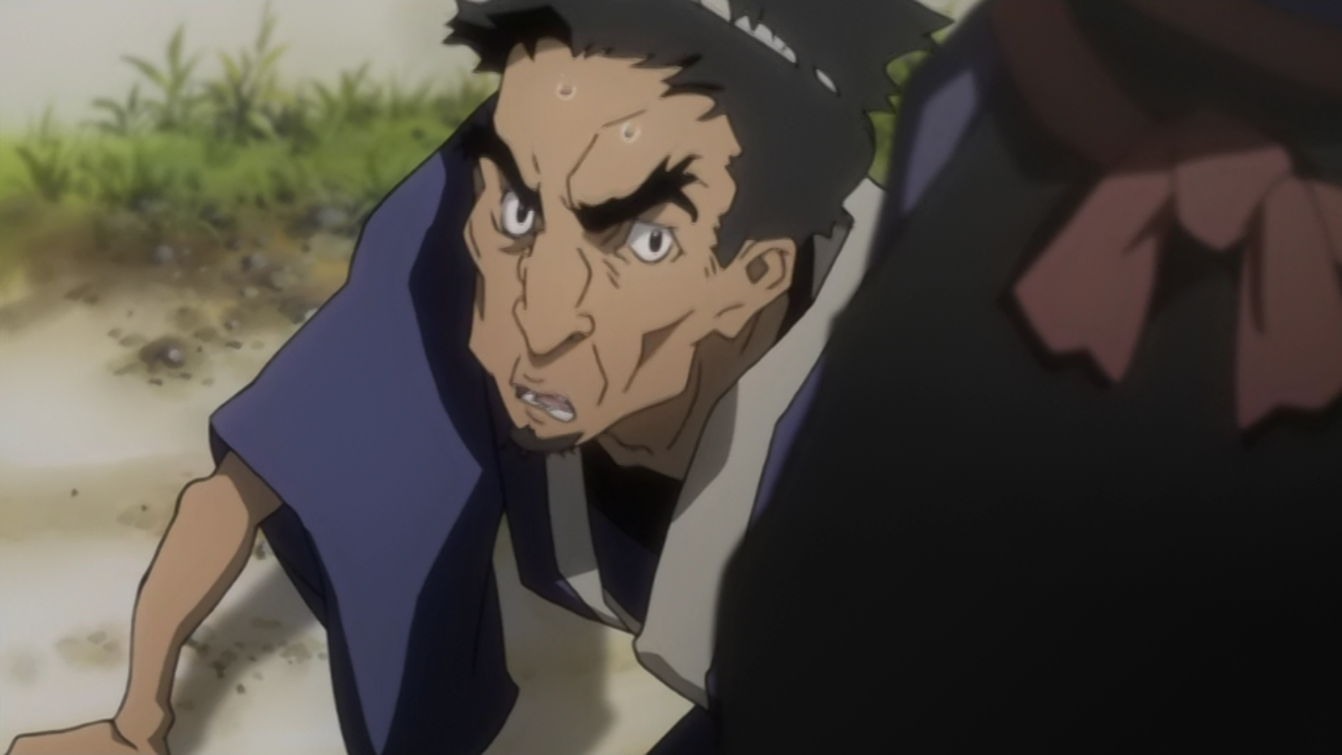

    I have created my AVS file, in which I use AvsPmod to do all my editing.
    LoadPlugin("F:\-----\Downloads\Encoding Software\MeGUI_2356_x86\tools\dgindex\DGDecode.dll")
    DGDecode_mpeg2source("C:\Users\-----\Videos\SAMURAI SHAMPLOO V1 E1.d2v", cpu=6, info=3)
    LoadPlugin("F:\-----\Downloads\Encoding Software\MeGUI_2356_x86\tools\avisynth_plugin\Colo rMatrix.dll")
    ColorMatrix(hints=true, interlaced=true, threads=0)
    Load_Stdcall_Plugin("F:\-----\Downloads\Encoding Software\MeGUI_2356_x86\tools\yadif\yadif.dll")
    Yadif(order=1)
    crop(2, 6, -2, -4)
    Lanczos4Resize(1024,576)
    LoadPlugin("C:\Program Files (x86)\AviSynth 2.5\plugins\TTempSmooth.dll")
    TTempSmooth()
    Import("C:\Program Files (x86)\AviSynth 2.5\plugins\LSFmod.v1.9.avsi")
    LSFmod(strength=120)
    LoadPlugin("C:\Program Files (x86)\AviSynth 2.5\plugins\gradfun2db.dll")
    gradfun2dbmod(thr=3,str=0,mask=false)
    So how the above AVS file looks in AvsPmod, is exactly how I want the video to look. I use MeGUI to encode to MKV, but when I encode the video, it seems as though it was pointless even going through the effort of adding filters. I've done so many tests and they all look the same - Watchable, and most people wouldn't complain, but I edited the video for a reason and it's not the result I wanted. My video is anime and the encoder setting is unrestricted 2pass Anime_Toon HQ, but I have tried others. I've played around with a few of settings within the profiles, but I don't seem to have much luck. I understand compression is the reason for this, so if someone can perhaps enlighten me, that would help me heaps. All I am trying to do is keep what I see in AvsPmod and encode with the least amount of quality loss as possible.

    Without a sample of your original unprocessed input, and without more info about what you want for output, there's not much anyone can advise. You can post samples of several seconds of unprocessed source video (choose a scene that involves motion) here or at file sharing sites. You appear to be working with MPEG source. You can use the free DGIndex utility to cut a sample m2v video -- audio isn't required.
    GradFun2DBmod: thr=3 is pretty strong stuff. Apparently you have reasons for using that setting, but one can only guess what they could be. No one knows what you're working with.

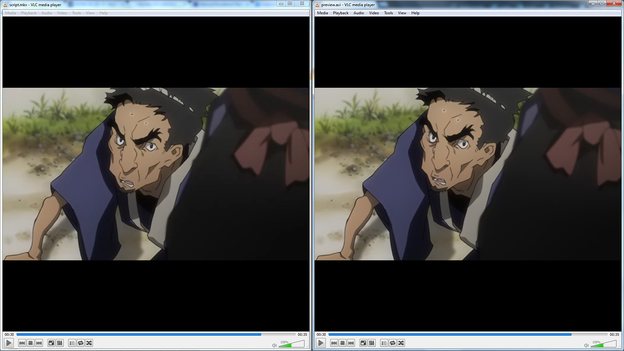

    Australia
    AVI Uncompressed.png - AVI uncompressed
    MKV.png - Finished MKV
    Both encoded using the same AVS file.

  4. why are your screenshots 1920x1080 ?
    yadif is probably not an ideal filter to use here - you would probably IVTC most anime, not deinterlace . It's responsible for those ugly line artifacts that you've upscaled in the screenshot
    what encoding settings did you use? use better encoding settings and lower crf settings, and it will eventually approach the uncompressed version

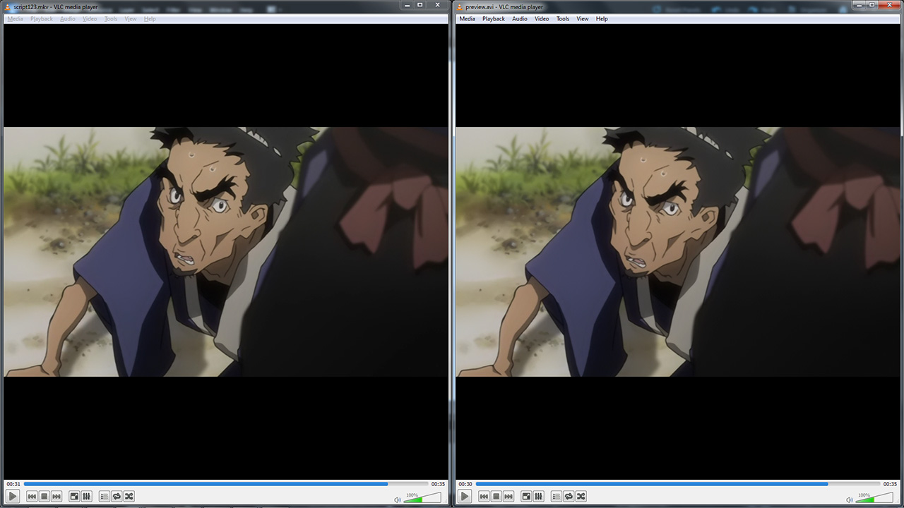

    This is what I get when I change the QF setting to 12.
    This is what I get when I leave the QF at the default settings.
    In Comparison1, there is still some noticable banding/artifacts. Will that improve if I play around with my script or is that the best I'm going to get?

  13. You can try adding a little more grain/dither to your script. To make up for what's lost due to compression.

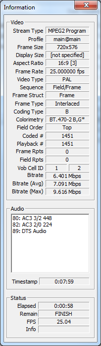

    Here is the sample which is more relevant to the pictures.
    Unprocessed Video2.m2v
    I have provided a photo of the Info Log. Probably not important, but provided nonetheless.
  22. Banned
    New York, US
    Thanks for sample 2. Will be spending some time with it. Meanwhile, you didn't seem arrogant -- not from my viewpoint, anyway. Hope you were not offended -- perhaps it results from a habit we Yanks seem to have, which some people refer to as murdering the language. And often many of us do tend to, mmm, get to the point around here.
    From this sample, I see what you mean. Still captures didn't accurately relay your problem -- things look quite different in motion. Offhand I think some of the excessive grain was purposeful, to avoid banding. However, it seems that the style of grain added was more coarse than needed. Difficult to say for certain. This sort of thing appears often with anime, even with many highly regarded issues. Sometime it can be fixed, sometimes not; sometimes it comes down to compromise. It's definitely more visible here than in your first sample. I'll try a few recommended tricks and post the results. I'm certain other members will pounce on this one.
