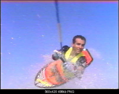

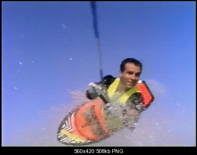

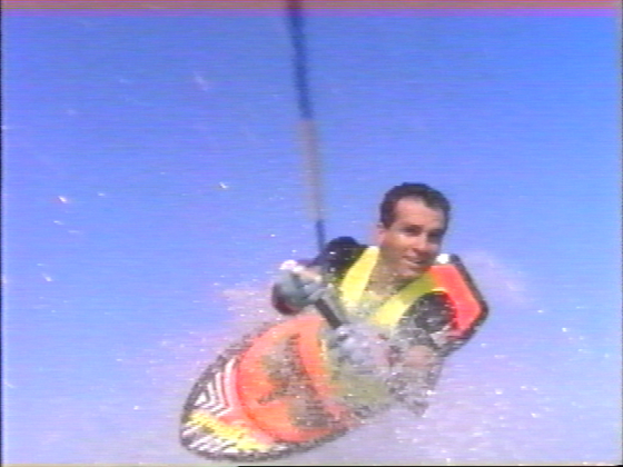

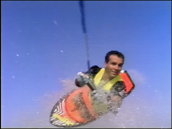

    A little more work. Added a "Step 3" by using a denoise and chroma cleanup routine borrowed from 2BDecided. I made a function out of it (this version is for non-interlaced video). Removing some of the noise killed some dot crawl on edges and some chroma smear. Also alloowed to reduce bitrate a bit. The script runs at about 6 fps. You could probably get rid of even more noise in the sky, but you'll lose too much fine detail in the water spray.
    Top image is where we started with the original AVI. Bottom image is result of more work, posted as "sample_Denoise_TestF.mkv" (23.972, pulldown not added yet). In the top "original" you'll also see lots of magenta rainbows in the sky, plus haloing and other junk. Note in the bottom photo that part of the white tow line was "averaged out". Well, you can't have everything. It looked like chroma noise to MCTD. If you can see the difference on playback, you're getting pretty good. Also cropped off some bristling dot crawl on the side borders and some frame hopping at top and bottom.
Name:	after steps 1-2-3.png

  30. Originally Posted by sanlyn View Post
    ...but every time one encounters stuff like that top border flashing it's really a hassle.
    I have HuffYUY installed but the video is all garbled for me, so I can't see anything to do this properly. But when there's a section of a frame needing some work, this often does the trick:
    A=Last
    B=A.ReplaceFramesMC(258,4)
    B=B.Crop(0,0,0,-450)
    Overlay(A,B,0,0)
    Just an example. The script says to interpolate 4 frames beginning with number 258 and to do it for only the top 30 pixels. Leave the lower 450 rows of pixels alone. You can also create a mask and feather it if necessary. It may not be applicable to this video at all, but I use something similar quite often. If the part being 'fixed' is relatively static and other parts of the frames are moving it can be very helpful in preventing motion artifacts in the rest of the frames. You can repeat it for different sets of frames as long as you have the memory available.
