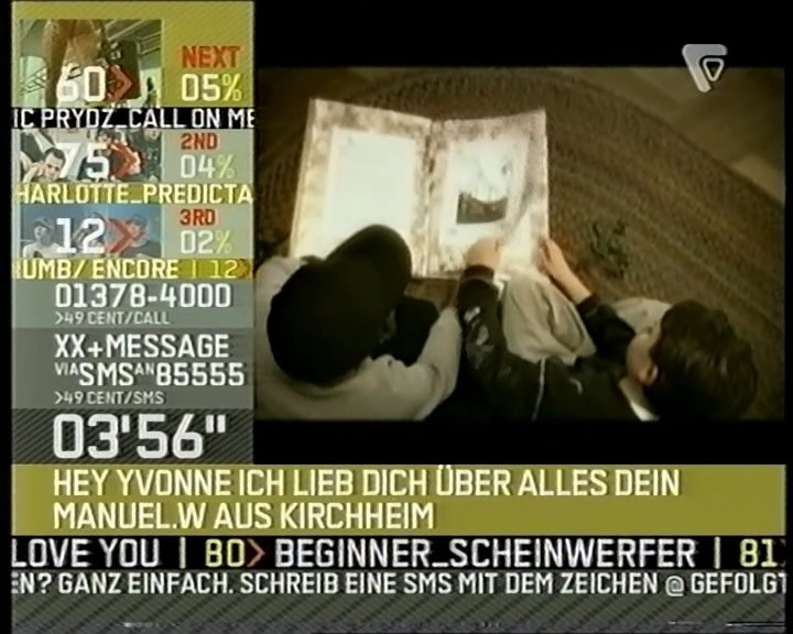

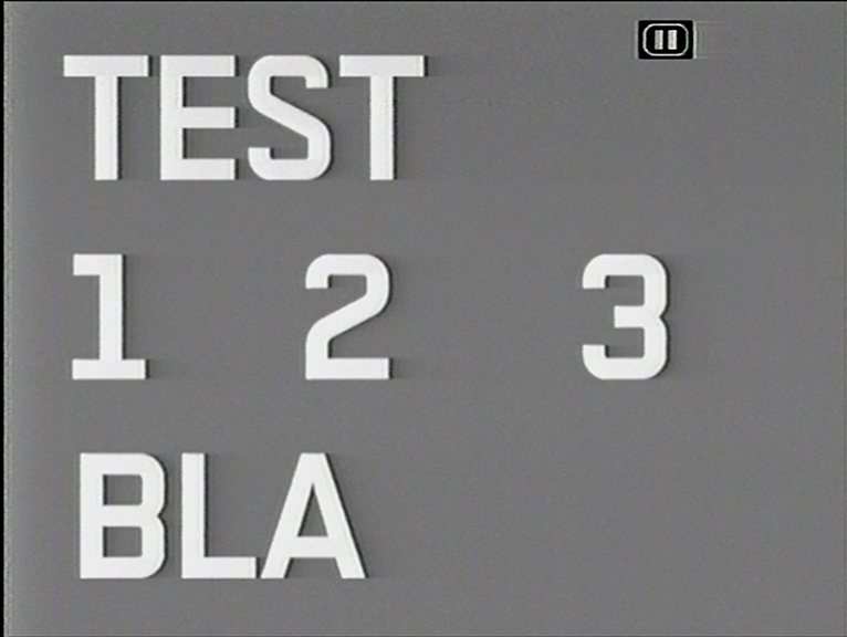

  3. I have the ghosting effect or shadow effect, when i play my vhs to an other player.
    Only in the vhs player, which the cassett was recorded, is no problem.
    BUT i want to play it on other players, or better in a svhs because the picture in my vhs player is to much soft.
    With an svhs you have a better shrapness.
    I try other cables, other outputs (cinhc,-svideo...) No luck.
    So I wanna capture it with an svhs with" shadows" and try with some plugins to solve the problem with the shadows.

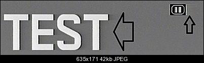

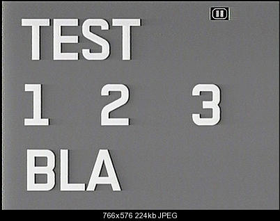

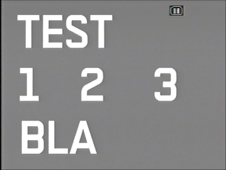

    VHS Click image for larger version
ID:	22142 no ghosting, but very soft picture
    SVHS Click image for larger version
ID:	22143 good sharpness, but ghosting/shadows

    What is the source of the video you are capturing? What are you using for capture? How were the images made? If the images are from PAL video, why is the frame size 766x576? Have they been resized from the original video?
    The SVHS player is sharpening too much. If the player has a sharpness control, turn it off. If you are sharpening during capture, don't sharpen.
    plugin to reduce halos: DeHalo_Alpha or DeHalo_ALpha_mt (http://avisynth.nl/index.php/DeHalo_alpha)
    plugin to reduce halo and luma/chroma smearing: aWarpSharp (http://avisynth.nl/index.php/AWarpSharp) or aWarpSharp2 (http://forum.doom9.org/showthread.php?t=147285). Examples of usage (use either of the examples below):
    --- MergeChroma(awarpsharp(depth=30))
    --- MergeChroma(awarpsharp2(depth=30))
    A plugin .avs to clean similar edge artifacts (DCT ringing): HQdering (http://www.animemusicvideos.org/forum/viewtopic.php?f=44&t=98079).
    anti-ghost plugin: ghostbuster (http://forum.doom9.org/attachment.php?attachmentid=12721&d=1330678606). Howeverm, the VirtualDub version of a similar filter (exorcist.vdf) is easier to use (http://www.softpedia.com/dyn-postdownload.php?p=113614&t=4&i=1). Unfortunately the best and easiest anti-ghost filter I've used comes with the TMPGenc Plus 2.5 MPEG Encoder. But none of the ghost filters are perfect.
  5. Turn off the sharpening filter in the SVHS deck. It is creating those oversharpening halos. You can reduce them in software with de-halo filters but it's best not to get them in the first place. The VHS cap in your first image is a far better starting point for further filtering.

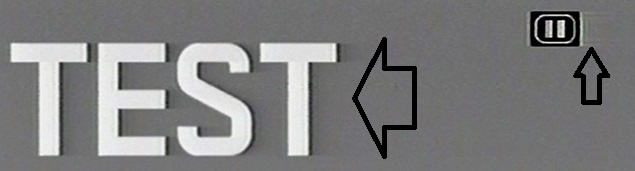

  7. hi
    the shadows are not permanently.
    they are often behind texts.
    here a example, you see only on different places there are shadows, not in the whole picture.
    http://www5.zippyshare.com/v/46803479/file.html ( click on download)
    and here the same tape with no shadows from the vhs player which was recorded but very unsharp ( Orion VH-2905 )
    http://www5.zippyshare.com/v/52226380/file.html ( click on download)
  8. The SVHS cap does have a lot more detail than the VHS cap. Does the SVHS deck have a sharpness control you can adjust? Try turning it down a little bit. Try:
    Dehalo_alpha(ry=0.01, rx=3.0)
    to remove the halos.

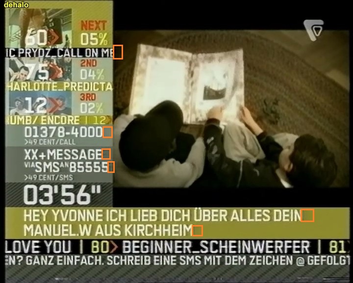

  13. Originally Posted by diginoob View Post
    My biggest problem are the shadows. Look at the videos, but not the black "3d" shadow, the shadow behind, no lets say to their right of some texts or logos..
    Again, those are oversharpening halos. Turn down the sharpening filter on the SVHS deck. Or use dehalo_alpha(). Yes, it will reduce the detail in other parts of the picture a bit too.

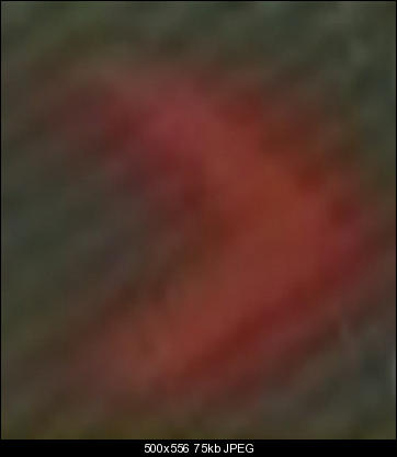

    Before:
    after dehalo_alpha():
    The VHS cap has no detail in the rug or the rug. The diagonal lines behind some of the graphics is gone too.

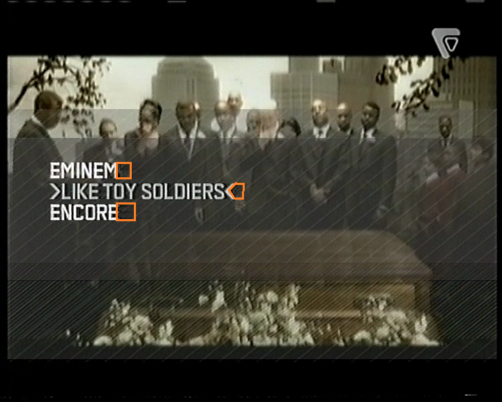

  15. Originally Posted by sanlyn View Post
    Would be quicker to just sharpen up the VHS.
    When there is a good sharpen filter, OK. I tried some but the resolutions were not so good.
    I digitalised 80% with my VHS recorder, so when I have a good sharpen filter, I can life with this capture and I save lot of time
    The Ghosting from the SVHS Player you mean I think comes from the NR Filter, in the future I can turn it off and turn the shrapness from "Edit" to "Normal" Mode. Thats no problem.

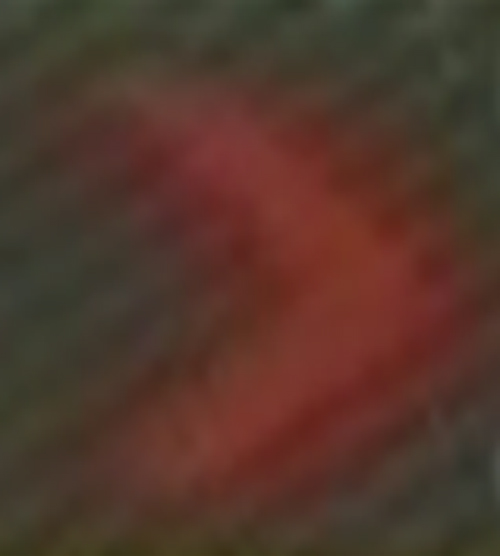

    BUT you guys don't understand, which shadows i mean. (It's a bit difficult for me to tell that in english)
    The orange marked areas I mean.

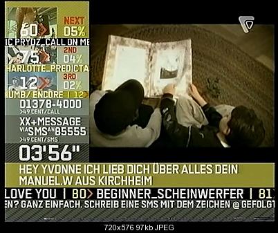

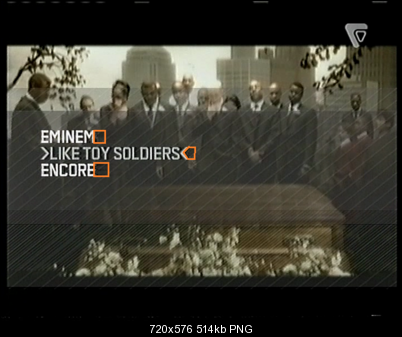

ID:	22167Click image for larger version
    The shadows which you mean, is correctly, bad too. So I do the Dehalo_alpha(ry=0.01, rx=3.0) in future.
    Exactly, that is why I will take a SVHS player. Or sharpen the VHS Captures. But when no linbes are there, I can't sharpen it
    But I can try, when there is a working filter.

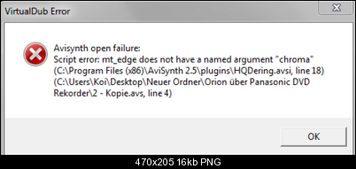

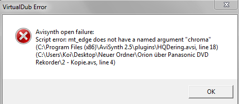

  23. With the HQdering i get this Error.
  24. I think you need a newer version of mt_masktools.
  25. Ive installed the MaskTools 2.0a48.
