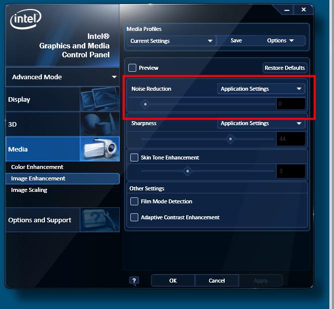

  4. A 720x576, 25 fps video encoded with h.264 at 8000 kbps isn't likely to have much in the way of encoding artifacts. That means the actual video was full of grain before encoding. And, of course, the job of the encoder is to preserve what its given as best it can. That leaves noise reduction on the TV as the most likely reason you don't see grain there but do see grain on a computer. Your graphics card probably has video noise reduction features. So try looking through the graphics card's setup applet and enabling them. For example, Intel's applet:
    Many players have their own image processing options too.
    Another thing to keep in mind: sharpness can increase noise. So if you have sharpness setting cranked up you may need to lower it. Or switch to an "edge enhancer" rather than a sharpener.
