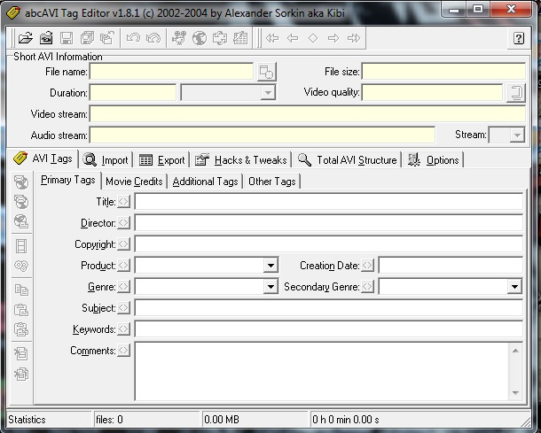

    Sure you can
    I used to use abcAVI Tag Editor to put all kinds of info into AVI/Xvids I made.
    You would not know it was there unless you checked in windows by right clicking and choosing properties or other software.
    I did it to track my stuff online to see if anyone was claiming it to be there's because most people do not check or think you can.
    I have never tried with MP4's or MKV's so I can not say for sure on those and I have always avoided crap like WMV & MOV like the plague!!

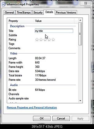

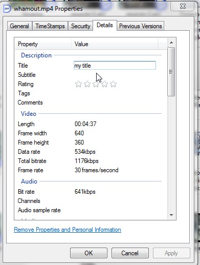

    Not sure about all the file types but I tried an MP4, which can be hard to inject Meta, with the ffmpeg copy parameters:
    C:\Users\Bud\Desktop\VHS2DVD>ffmpeg -i C:\Users\Bud\Desktop\VHS2DVD\Wham!AC3_6Ch
    annel.mp4 -metadata title="my title" -acodec copy -vcodec copy whamout.mp4
    It copied without recoding and the metadata shows in the file:
Name:	ScreenHunter_22 Sep. 11 23.37.jpg
    Shouldn't be too hard to build a GUI for running or use a batch file, but each Video format (AVI, MP4, FLV, etc.) has its own limitations on what can be added as Metadata as noted in the articles linked above and you would have to be careful, at least in batch processing.
