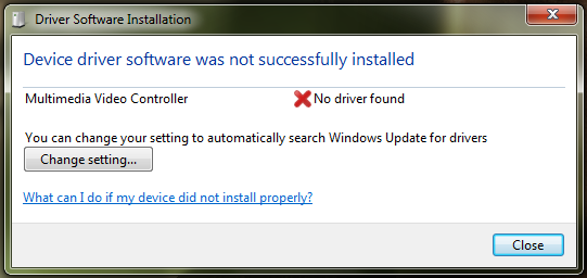

  1. I have an AverTV HD DVR PCI-E card (c027) capture card, I've had it for two years and its always worked great, I recently formatted my hard drive and re-installed Windows 7, I went ahead with routine installing of the drivers but I seem to be running into trouble, when the drivers install, I get the windows message stating
    "Device driver software was not successfully installed."
    "Multimedia Video Controller No Driver found"
    Here's a picture

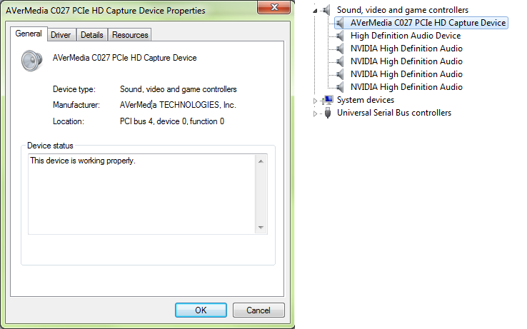

  3. Yes, device manager shows the correct name and lists the driver as working properly, here's a pic
    As for resolutions, I've tried everything possible on both the Avermedia capture software and other software. I've also tried changing the resolution of the devices I'm trying to capture from.

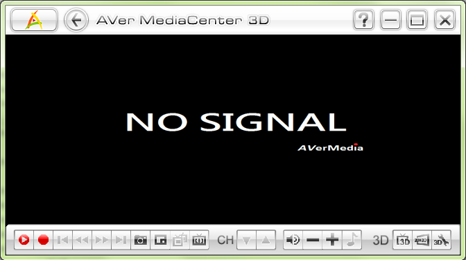

    As for capture filter, I'm not sure where to look for that. I just know that regardless of capture software, I'm met with a black screen which displays the aver logo and no signal detected like pictured
    Under Avermedia settings it does have the driver device selected and it the name shows up properly as well. Using other software, they usually don't have an HDMI option for me so I selected SVideo which always works as HDMI, doing so just leads to same result.
