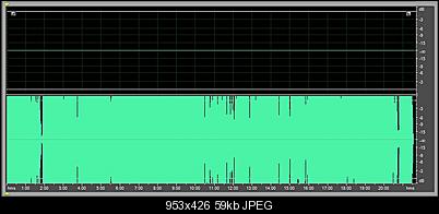

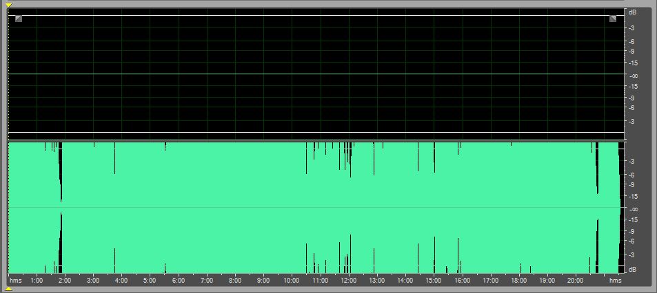

    continuing the rant from earlier about "professional" wedding videos. Another friend of mine mentioned they could no longer play their wedding video DVD. Being the nice guy I am I offered to take it and see if I could make another copy for them..also give them the digital copy to keep as a backup. I figured the DVD was just scratched a bit and the player wouldn't play it.
    Thankfully I was right..I was able to copy it over to my PC and I played it just to see what it looked/sounded like. Below is the audio extracted from the Reception (the wedding ceremony was the same).
