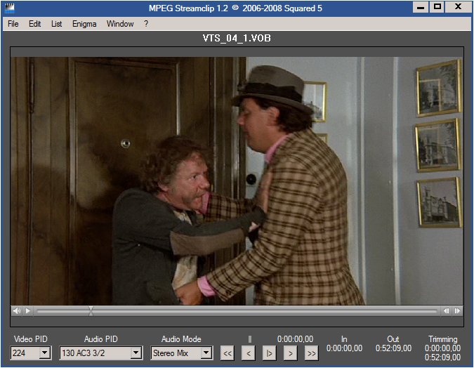

  4. For what it is worth:
    Get both scrubber and audio during playback on Windows 8 x64
