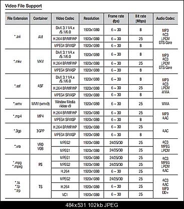

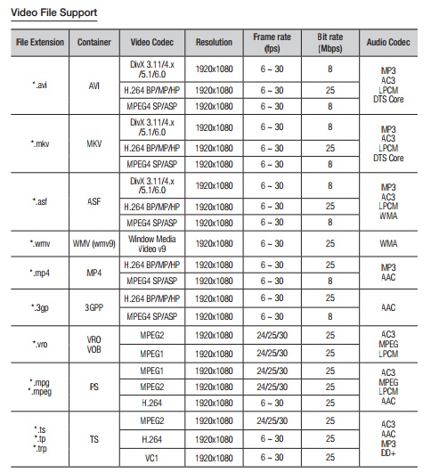

	Assuming the files play correctly on another device, it's typically a byproduct of the files exceeding the specs of the player.
 If you can find the supported file specs for the player, compare the files to what is supported. Things to watch are the supported codecs (both video and audio), resolution, and bitrate (both audio and video).Google is your Friend
	Thank you for the reply. I checked for the specifications and as far as I can see, none of the files exceeds the recommended specifications of the device. Even more so, the second file which is playing just fine, has an even higher bitrate than the first one. I really don't understand what the issue is. I was wondering, could it have anything to do with the USB stick and maybe I should use a different playback device? Then again, if that would be the issue, it should occur when playing over the TV or the Blu Ray player.
