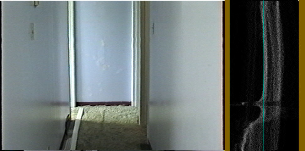

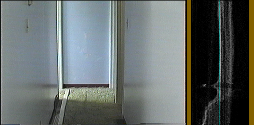

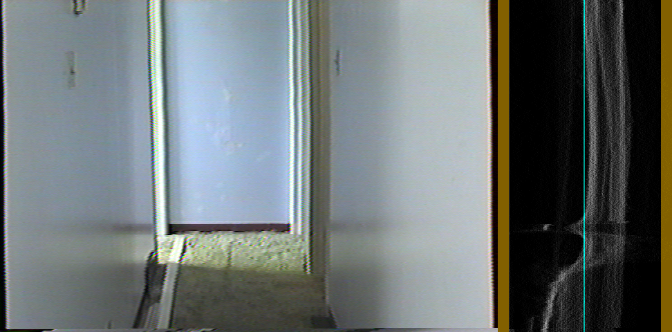

    From what I've seen it depends on the combination of your VCR's sharpness level and the comb filter in your capture device. If you're not seeing visible artifacts there may not be much to improve upon.
    All of these images use composite output, from two regular VCRs:
ID:	19955 Click image for larger version
ID:	19956 Click image for larger version
ID:	19957 Click image for larger version
    The amount of rainbowing on that one image really surprised me.
