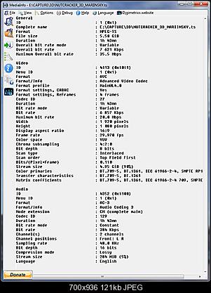

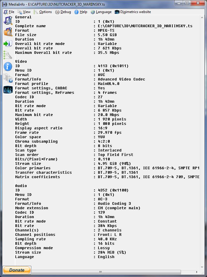

  4. Here's a MediaInfo screenshot of a file that works as I explained above:
Name:	Mariinsky Nutcracker.jpg
    Pull! Bang! Darn!
