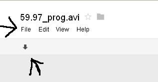

    You can download the files that I uploaded from the page the link takes you to. Look for the down arrow in the upper left corner or click on "file"
    Image Attached Images
  2. Yes, after selecting File -> Download I get a new page that indicates the file wasn't virus scanned and a button that says Download Anyway. The MPG file downloaded fine by pressing the button, but nothing happens after pressing the button with the AVI files.
