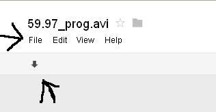

    Some samples in various stages. I don't have an app that will directly cut and save a sample from the .vob file that DVD Architect Studio rendered.
    For anyone not familiar with Google drive, use the arrow to the upper left to download or click under "file" directly above the arrow. Don't go by the crappy bitrate starved preview player. The 59.97 progressive file is the largest at 40+ megs which is a couple of seconds.

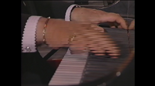

    What I find is in Media Player Classic the reinterlaced and mpg files look okay, the only place that reflects the issues I see on the TV is the preview window of Vegas.

  30. I think Vegas screwed up your video -- bff.mpg has improperly resized fields. But I haven't been able to download the interlaced AVI yet.
    I still can't download either AVI file. But After seeing the FLV video of the interlaced file I don't think Vegas is at fault, I think you resized after interlacing.
