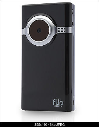

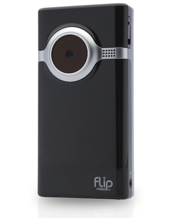

    I frequently (a few times a month at least) record video playing on a 32" lcd and have never had a problem as long as the room was well lit.
    I do it to demonstrate different video game systems working with different software.
    And I use a cheap Flip video camera that records in HD and they look damn good.
