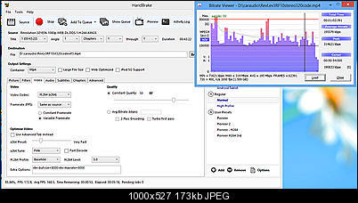

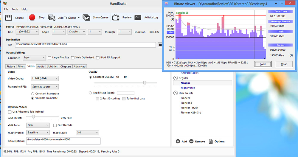

    ave bitrate (195579kbps) peak (314621kbps)
    I will try encoding it again. There must be some mistake
    Update: I encoded it again (2nd try), and used also ref=3 and it gave me the same results! average (194707kbps) and peak (315086kbps) bitrate is way high.
    Code i used is:
    1st try:
    vbv-bufsize=8000:vbv-maxrate=8000
    2nd try:
    vbv-bufsize=8000:vbv-maxrate=8000:ref=3
    Update: Theres something very wrong, i encoded again removing the code and it still gave me a high reading in bitrate viewer. Ill try to close / re-open handbrake and encode again.

    It might be worth paying the log file a visit and investigating the command line Handbrake is using. Maybe look for an encode log where you added VBV settings yourself, and then for one where you didn't.
    I looked back through the thread (post #20) would seem to indicate Handbrake has become rather VBV enthusiastic, automatically adding the appropriate VBV settings for the level being used. You didn't add vbv-bufsize=10000:vbv-maxrate=10000 yourself, I assume? So I guess it might pay to investigate how much x264 command line cleverness was endowed on Handbrake and if manually adding vbv-bufsize=8000:vbv-maxrate=8000 yourself is working correctly. I'm not even sure VBV settings will be included in the command line in Handbrake's log file, at least not until you add some yourself. It could be the normal VBV restrictions are "hard-wired" into the version of the x264 encoder which Handbrake uses.
  20. Hmmm that's a bit too technical for me now lol. If someone could help in and do the test on how to manually add a max bitrate on handbrake, itd be nice to know. Thanks
  21. Best as I can tell from a few quick encodes, Handbrake does add VBV restrictions automatically according to the chosen profile and level, but if you specify something else, it uses "something else" instead.
    For each little test I only encoded 500 frames. CRF10, veryfast, x264 speed preset, baseline profile, level 3.
    With "vbv-bufsize=8000:vbv-maxrate=8000" included, MeGUI's output had an average bitrate of 6554kbps and a peak bitrate of 11295kbps, and for Handbrake they were 6533kbps and 11144kbps respectively. Without VBV settings, MeGUI produced an average of 7386kbps and a peak of 13776kbps. For Handbrake, 7420kbps and a peak of 13885kbps.
    I guess there's only so much VBV can do. It appears the settings are being applied but I assume they don't act as a "hard limiter" on the bitrate as such, or they can only limit it successfully when the average bitrate realistic. By using such a low CRF value with fairly restrictive VBV settings, you're effectively telling the encoder to achieve two opposing goals. Output a quality which requires a bitrate of "x" while not using the required bitrate.
    I suspect once you're encoding with a CRF value which isn't likely to have more than brief encounters with a bitrate higher than 8000kbps, the VBV settings will be able to do their job and the playbak problems will disappear.
  22. The issue may only be in how short term bitrates are reported. If you look at Bitrate Viewer's options there are three different ways of measuring bitrate: per second, per GOP, per GOP enhanced. Those don't correspond to what's truly important to a player. I trust x264's calculations more than Bitrate Viewer's.
    A DVD player is a hardware device that has a fixed amount of memory and a fixed max rate at which data can be read off the disc. The DVD player uses a read ahead buffer and will have several compressed frames and several decompressed frames in memory. One of the decompressed frames is currently being displayed, other decompressed frames are waiting to be displayed, several frames are in the process if being decompressed, and finally the data from several compressed frames is in memory waiting to be decompressed. What's critical to the player is that this pipeline of frames never runs dry -- that every 1/30 second there is at least one frame decompressed and ready for display. That means you can have short term bitrate spikes higher than the maximum sustained rate at which the drive is reading data off the disc -- as long as there are frames around it with a lower rate.
    This pipeline is what the vbv settings in x264 correspond to. Bitrate Viewer's reports don't take this pipeline into account, only showing per second, or per GOP bitrates.
    If you find that the vbv 8000 encodings still give you problems try setting it lower until you find what works. For the time being I would leave reframes set to 1 to rule out problems with that. Once you've found what vbv settings work, go back and increase reframes to find what max the player allows. Careful though -- max reframes is likely to vary with the frame size. It might be safest to just leave it at 1.

  25. Originally Posted by jagabo View Post
    Yes I see what you mean. Although why would the frame based method show a maximum bitrate lower than the average bitrate?
    I still had one of the VBV test encodes loaded in Bitrate Viewer and changing the method for reporting bitrates had the following effect on the maximum bitrate reported. Average bitrate remained the same (6554kbps).
    Second based: 11295 kbps
    GOP based: 9741 kbps
    Frame based 2335 kbps
  26. Originally Posted by hello_hello View Post
    If Bitrate Viewer is confused about the frame rate you can't trust what it says about bitrates. Different parts of the program may calculate rates differently resulting in different mistakes when the frame rate is misunderstood.

    Second based: 11295 kbps GOP based: 9741 kbps Frame based 2335 kbps
    well the math is off somewhere
    seconds bitrate 11295, frame bitrate 2335... even if averaged ..30 frames times 2335 is over 60,000
    Not 11295
    problem is.. where do the numbers come from
    frame could be Decompressed display rate
    while seconds could be compressed data from the file
    it seems to me to be the only thing that explains the 5:1 difference
    comparing apples to oranges , so to speak
    makes it hard to understand what is really happening
    stick with 2.2 and rf18 or rf 20
    and i think you will be OK
  28. Yep. I'm trying out level 2.2 and RF18. So far so good.
    By the way, is there any better alternative to bitrate viewer?
  29. Originally Posted by theewizard View Post
    It's all meaningless because Bitrate Viewer screwed up the frame rate calculation. Use MKV instead and you'll get proper results. Or remux the MP4 into MKV with MMG and check the bitrate graph with that.
  30. or... get an alternative program to bitrate viewer that doesn't screws up the frame rate calculation =)
