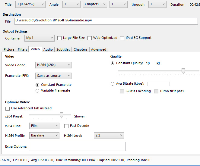

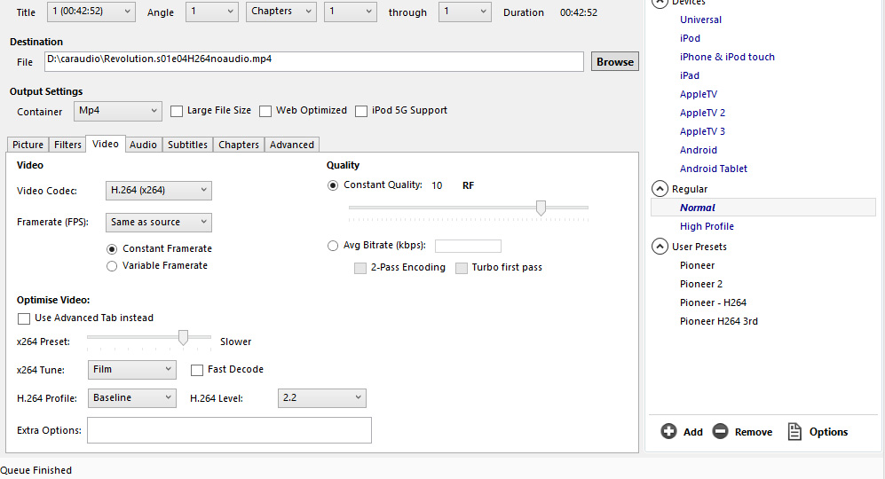

    my settings now: (Handbrake)
    Display Size = 800x450
    Container = Mp4
    Video Codec = H264 (or Mpeg-4 Ffmpeg)
    Anamorphic = Loose
    Modulus 16
    Äudio = AC3 / Codec = AAC (faac) Bitrate = 160
    Mixdown = stereo
    Profile = Baseline
    Tune = Film
    H264 level = 2.2
    H264 preset = default
    Framerate = same as source (variable)
    Quality = Constant (10)
    Should I click advanced settings?
    My computer for encoding = i7 (3.6Ghz 3820) 32GB ram multiple Hard drive Geforce 660ti
    Note: When using xvid, the video plays without any problems on my head unit (i use Xvid4PSP to encode but the thing is, audio is not as good - only mp3 320bit- and batch conversion gets errors in xvid4psp) xvid file size is 500-600MB

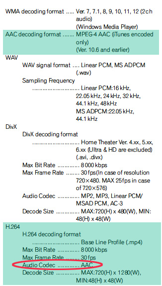

  5. If the player's manual tells you the AVC Profile and level it supports, use them (assuming you're not already). High Profile, Level 4.1 is pretty standard these days. Handbrake's High Profile preset uses Level 4.1 (along with the default x264 settings), but you can change it. Hopefully once you do, the stuttering problem will go away. The number of reference frames etc should stay within the limits of the chosen Profile and Level.
    PS And if the player has a maximum resolution it supports, you'll need to resize if necessary to stay within those limits.

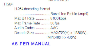

  6. yeah the manual of pioneer states this:
    Baseline Profile
    8000kbps
    max frame rate = 30fps
    audio codec = AAC

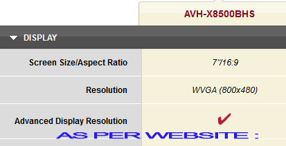

    Decode size - Max 1280 (W) x 710 (H) - (however, on the website, it says that the screen resolution is 800x480 so i lower my size to 711x400) I set it at 720 but it automatically makes it 711 maybe because of the anamorphic loose and modulus 16
    However, it doesn't state what level I should use. Since the manual says the max bit rate is 8000 kbps, then I assumed that it is level 2.2 since lev3 is max 10,000kbps and level 2.2 is 4000kbps. Am I right on this?
    The last part doesn't quite make sense. 711 isn't mod16 (it doesn't matter what you use anyway, so if you need it to be mod2, make it mod2). Do you mean Handbrake automatically makes it 720?
    You're possible getting the width and height mixed up. "Max 1280 (W) x 710 (H)" seems correct. You seem to be setting the width to 720 (or 800) when it's the height which is limited to 710.

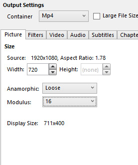

  8. Hi. Thanks for the reply
    In handbrake, i put 720 in the width box but it automatically sets the width to 711 as shown below:

    Am I right to interpret this such that even if H264 can decode at a higher size (1280x720), I should still follow the native resolution of my screen which is 800x480 ? (is that my native resolution?)
    Is CRF also the same as RF? It so then yes i am using this and my setting is 10, sometimes i try 15.
    What will level 3 offer over level 2.2? If its quality then i think im already ok with the picture quality. However, if its stability then i'm highly interested as I want my video to play as smooth as possible (with acceptable quality).

  11. umm, so how do i set all the bit rate in handbrake? i don't see any setting where I can place 6000kbps. Also, should i only use 18 to 20 for RF value? does RF value make decoding harder for my pioneer head unit? Hmmm maybe my video skipped because i tried putting an RF value of 2, 3, 4 and 5 before? (was trying different RF values)
    Also 800x450 might not be good because that is not SD already right? It might make things harder for my head unit to decode. What I do is only 720x400 but it turns out to be a box when played. I just hit the stretch feature in my pioneer and the video automatically fills the entire monitor.
  12. Originally Posted by joms View Post
    Change from Quality based encoding to Avg Bitrate based encoding -- on the Video tab. You have to choose one or the other.

  16. Originally Posted by joms View Post
    [Attachment 19915 - Click to enlarge]
    For your info:
    [Attachment 19916 - Click to enlarge]
    [Attachment 19917 - Click to enlarge]
    711 is the display aspect ratio, not the resolution. That's the result of using anamorphic encoding. The resolution and display aspect ratio are only the same if the video contains square pixels. DVDs are the most common example. 720x480 isn't 4:3 and it's not 16:9 either.
    So for your example the video is actually being encoded at 720x400, but in order to display correctly without distorting the picture, it'll display using 711x400. If the playback device doesn't support anamorphic MKV/MP4, then it'll display as 720x400 instead of 711x400, so the picture will be stretched horizontally a little.

  17. Thanks, I marginally got what you meant by anamorphic and aspect ratio.
    Question is, which one would be easier (non taxing) for my pioneer head unit. (Therefore less chances of getting freezes)
    a) set the picture size to 800x480 (pioneer's resolution) and remove anamophic and uncheck the keep aspect ratio
    b) set the picture size to 720(width) with anamorphic Loose and Modulus 16 (giving me a display aspect resolution of 711x400 then just using the Zoom/stretch/fill command of the pioneer)
    How would I know if my Pioneer head unit supports anamorphic encoding? It does not say in the manual nor in the website.

  19. ok i tried following the smaller SD display size encoding (711x400) but it still gave me problems. The screen still froze from time to time but I can continue the video by pressing the play/pause button.
    My settings: Using handbrake
    Container = mp4
    Codec = H264
    Picture width = 720
    Display size = 711x400
    Anamorphic = Loose
    Modulus = 16
    FPS = Same as source
    Quality = 10
    X264 tune = Film
    H264 Profile = Baseline
    H264 Level = 2.2
    Audio Source = AC3 5.1
    Codec = AAC (faac)
    Bitrate = 320
    Mixdown = stereo

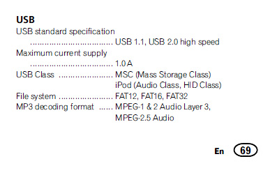

  21. Hmmm I checked the manual again and it shows this for USB Connected devices (my thumbdrive):
    [Attachment 19930 - Click to enlarge]
    [Attachment 19929 - Click to enlarge]
    Do you think my video freezes because of my audio not being AAC Itunes encoded? Can Itunes Encode a video with format H264 / AAC?

  24. This is the setting that i used:
  25. But what preset did you have selected to the right of that? The preset sets a bunch of defaults which you can then modify with the settings in the controls you pictured. You can't change the number of reframes there. You either have to start with a preset that has a lower reframe limit or use the Advanced tab intead.
  26. I just use the Regular - Normal Preset
  27. After selecting the Normal preset, try changing the Profile to Baseline and the h.264 level to 3.0. Encoding with that will give 1 reference frame.
  28. Ok. im doing this right now. So the only difference from what i did is using level 3.0 instead of the version 2.2 I am currently using.
  29. Baseline profile at level 3.0 or 2.2 should use only one reference frame. I don't know why your previous video shows 7 reference frames instead.
  30. Thanks!
