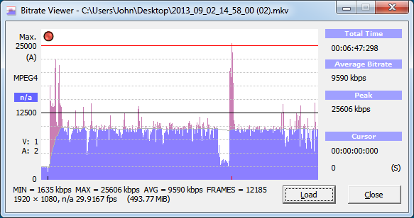

    Jagabo is correct regarding compression issues and may be worth looking into. Here is a link to a discussion on AVS Forum regarding Time Warner quality: http://www.avsforum.com/t/1376604/just-got-time-warner-cable-why-is-my-hd-quality-so-poor

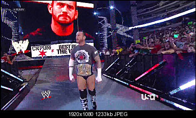

  15. Originally Posted by usually_quiet View Post
    I guess I'm missing something because your screenshots don't look all that terrible to me.
    You think this image isnt' so bad? (Be sure to view it at full size.)
    I'd be horrified if my capture device gave that from a clean 1080i source. I'd rather watch it on VCD.

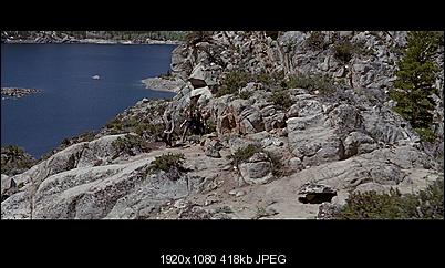

    Compare that to a "best" cap of a clean source with an HD PVR 2:

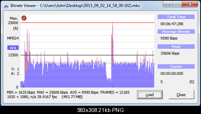

  21. Uploaded two sets of files that has 2 different clips. Both :20, one is 1080i and the other is 720p; untouched.
    http://www.mediafire.com/?992bewqxa22e7ex
    http://www.mediafire.com/?nqxu6nba631sf6d

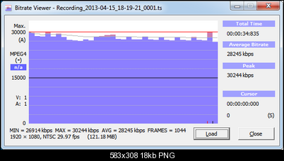

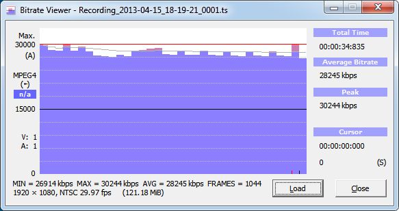

  22. Originally Posted by usually_quiet View Post
    The Elgato Game Capture HD's software supports a bitrate of up to 30 Mbit/sec for 1080i using "best" quality setting http://support.elgato.com/index.php?_m=knowledgebase&_a=viewarticle&kbarticleid=4411 However I think it must use variable bitrate, not constant.
    You can't directly specify the bitrate or CBR/VBR. There's just a slider that ranges from good to best. At best, with 1080i or 1080p sources you get 30 Mb/s CBR, or very nearly so. Here's a Bitrate Viewer report of a mostly static clip at recorded "best":
    At lower quality settings you get more of a VBR.
    Regarding the OP's problems: I think there's either something wrong with his HD PVR (which doesn't seem likely since his 720p caps don't look too bad) or his cable company is just over-compressing the channel and he's got some poor deinterlacing going on.

  25. Were those 1080i caps an HD channel or upscaled SD? The blocking in the image is 16x16 blocks not the usual 8x8 blocks. You really should post actual clips from the device, not processed images.
  26. Originally Posted by jagabo View Post
    HD channel
    And I did post links to clips. If you look up ahead I posted 2 links for 2 different clips of my source.
    One in 1080i and the other in 720p.
  27. Sorry, I missed the post with the clilps. I think your cable company is over compressing. And you have some kind of decoding/deinterlacing problem on your computer. My cable company typically sends good 1080i channels at around 9 Mb/s with occasional peaks up to 25 Mb/s.
    That's a clear QAM capture so it's the MPEG 2 data from the cable company.
  28. The thing is is that it looks fine on T.V. while recording, but it looks like s__t on the recording.
