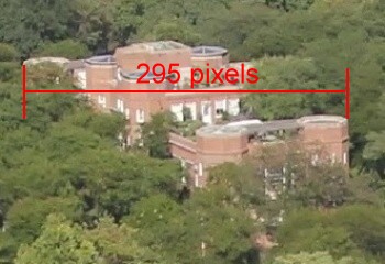

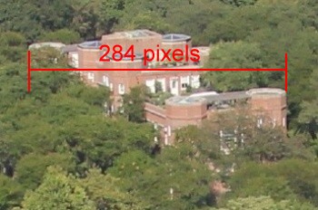

  1. So, I'm trying to figure out the optimal quality of a time-lapse I've created.
    The original, using Lagarith was 1.7GB.
    Then I encoded it with Handbrake and the output file was 170MB (1/10 the size).
    Looking at a 100% crop, I can't notice the difference.
    What do you think?

  3. There's a slight loss of detail in the image on the right. It's hard to say if it's from the encoding, the resizing, or both.

    Yes, you can see a slight loss in detail. Look at the window frames. The loss is due to interpolation. Anytime you enlarge something, new pixels have to be created, and they get fuzzy.

  27. Why this size discrepancy in your original post?
Size:  26.4 KB Name:  pic2.jpg
    Scaling causes a reduction in quality. JPEG encoding causes a loss of quality. JPEG encoding with different cropping will give different drops in quality. This evidence is useless.
    I have no idea why there is a discrepancy. Both are 100% crops of a 3840x2560 file.
