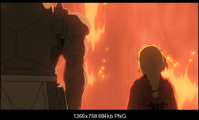

  1. When streaming using potplayer i get pillarbox the video isn't fullscreen Click image for larger version

    Welcome to the forum.
    That said, there is no pillarboxing in the image posted above.

  3. thank you. how do i remove the black edges the video isn't fullscreen its not covering the entire screen
  4. Banned
    New York, US
    What is the aspect ratio of the display monitor?
    What is the aspect ratio of the video?
    Let's say your display device is 16x9 (1.78:1). Most commercial movies are not produced at 16x9. They are produced at 1.66:1, 1.88:1, or 2.35:1 . None of those aspect ratios will completely fill a 16x9 screen. The only videos that are produced at exactly 16x9 are TV shows and consumer video cameras.

  5. the resolution for monitor is set at 1366x768 when using vlc it covers the screen but i can't get vlc to keep the video english when the next episode plays even when going into preferences changing audio to english it doesn't do this with another dual audio file i have

  6. i fixed it by unchecking keep aspect ratio
  7. Originally Posted by la321 View Post
    The reason you had letterbox bars is because you were watching a 1.85:1 movie on a 1.78:1 screen. The bars are supposed to be there. By turning off the Keep Aspect Ratio setting you are distorting the picture. 1.85:1 to 1.78:1 probably isn't noticeable but if you view 2.35:1 (typical widescreen movie) or 1.37:1 (old ~4:3 movies) sources it will be obvious. You would be better off learning to live with viewing movies at their original aspect ratio.
