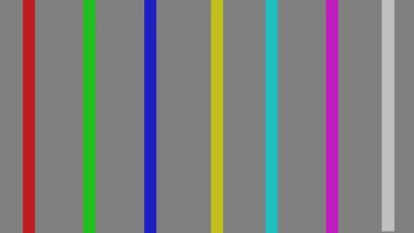

  2. Oh, by the way, even though your current machines appear to be handling variable frame rate encodes, I recommend you stick with constant frame rate. VFR only gets you a tiny bit more compression (typically less than 1 percent smaller files) but there are many devices that have problems with it. I don't think it's worth the tradoff.
    Attached is an interlaced x264 encoded MKV which you can test with. You should get very smooth motion of the vertical bars and there should be no comb artifacts, ghosting, etc. It should look like this:
