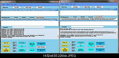

    You can extract both with ffmpeg:
    FFmpeg -I "c:\path to Inputvideoname\video.flv" -vcodec copy -an outputname.flv <- for the video
    FFmpeg -I "c:\path to Inputvideoname\video.flv" -vn -acodec copy outputname.aac <- for the audio

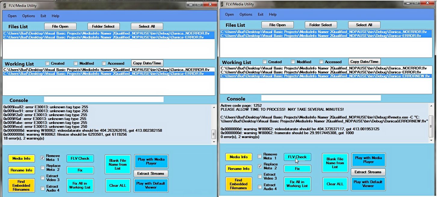

    There are a multitude of programs to mux but a quick question if I may... I agree that most FLV are messed up upon downloading, refusing to play, copy, seek, wrong duration shown, out of sync. etc. butmost can be fixed by removing or replacing the Meta Data as shown below.
    This can be accomplished by:
    Replace:
    FFMpeg -i "c:\path to Inputvideoname\video.flv" -vcodec copy -acodec copy "outputname.FLV"
    Remove:
    yamdi -I "c:\path to Inputvideoname\video.flv" -o "outputname.FLV" -M

    My application basically is a gui front end and just does the remove or replace to fix FLVs so the results probably won't be much different. Any chance you can post one to examine? They are usually fairly easy to adjust once the reason is found. My appliction does use the new Check facility FLVMeta which now has a very good check facility so you could try it and see what errors it shows before and after fixing.
    I did notice one bug in my program still. I left a popup msg if you drag and drop but you just click ok and go. It was just a debug message and doesn't affect the program otherwise.
    Basically unzip the files to a folder. Run the program, open one or more files in files list. Move them as you want to working list by selecting each or select all button. Select one in working list and hit check button. Read what it says in console windows. Try remove or replace and it copies the file minus the meta or with new and adds it to working list. You can just highlight that NEW OR YAM file and test immediately.

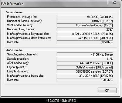

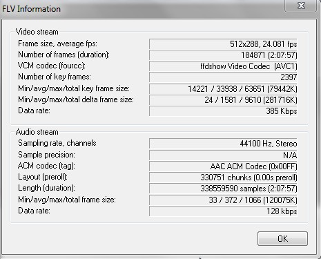

    OOOO, tough question... which worked better. The best results I got were with removal of Meta with Yamdi and then it pretty much was okay up to 01:49:00.000 but got out of sync in jumps up to about 1 second by the end. Since Replacing Meta used FFMpeg, it tended to rewrite timings and frames even though told to copy so the video tended to freeze here and there.
    I also tried to split the video into 2 pieces, good section and bad and worked with both but sadly their is just a lot of duplicate timings and missing data in the last part to match up. The reason the original and others load into my VirtualDub is that I have the FFDshow codecs and AAC ACM codecs loaded:

    You have to turn the AVC1 codec on in FFDshow and it should load okay but I'm not sure what error you got trying to load it. As far as plugins I have them all, especially the Directshowsource and FFInputSource but they weren't actually needed.
