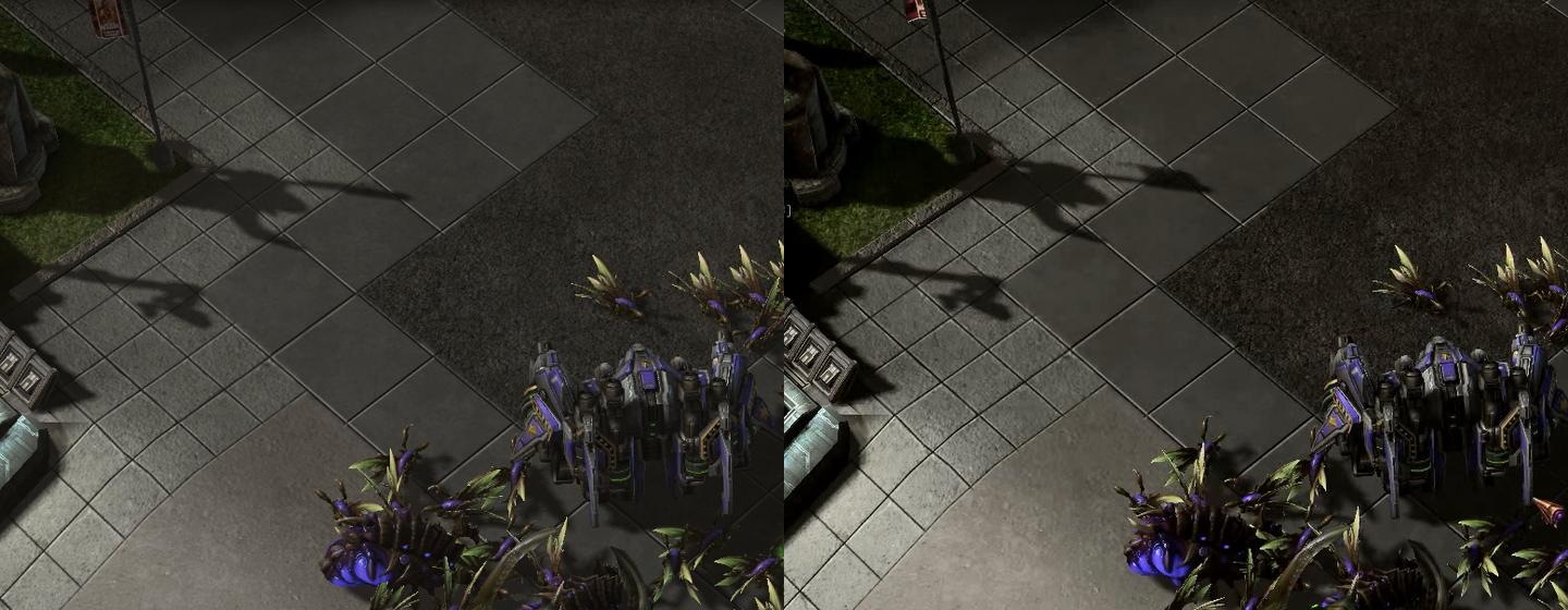

    I'm using Xvid Mpeg-4 video codec as a standard but other codecs of Win 8 have the same result. When compressing to AVI with the Xvid codec appear darker or their gamma is higher, I don't know. Here is an example from a game (sc2) recorded with FRAPS
    On the LEFT is the original uncompressed video. On the RIGHT - compressed video after compression with Xvid or whichever other codec w same result, this screenshots are taking while playing the two videos.
    Looking at the robot in the center, you see the details on his back on the left, the darkened on the right, even the tiles, the ground looks different and darker. I want to make it like on the original video.

    I use AVS Video Converter, yes I was thinking whether I am not seeing original video but the point is, Frap does fine since the left picture shows it as it is, no quality loss. The prob comes when I do compression and I use Xvid installed by me but other codecs have the same darkening effect even worse quality.
    And I haven't played both at the same time, one at a time and they are different as on the pic.

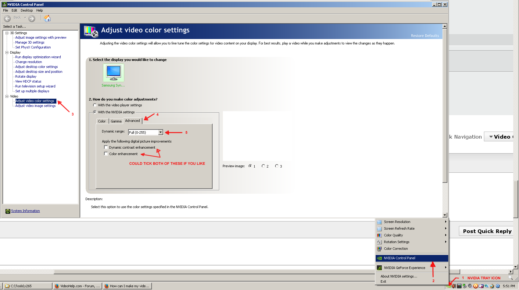

    Nov 2002
    NVIDIA Video Card Settings...

  16. Using the video card's proc amp is not a good way of "fixing" this problem. It will have an adverse effect on most other videos (too little contrast).
    Can't I do it a one-time thing? I have a video, I compress it with Xvid using the option above 'With Nvidia settings', then I bring back the usual settings e.g 'With the video player Settings'
    Anyway when I changed the color settings with Nvidia then compressed with Xvid, it's the exact same result after compression, so that didn;'t work.
    Well... lol. I downloaded latest VirtualDub x32 bit, only compressed with Xvid MPEG4 and the Audio Codec without even changing filters or using anything like that, here is the comparison as opposed to my first post
    ... I should use VirtualDub for problematic vids?

    Where I am confused now is that comparing the two sets of stills both the images on the right - the compressed ones as you say - appear lighter than the original.
    I now wonder whether your graphics systems is playing visual tricks.
    But if you are now happy, who am I to argue.
    But then wouldn't the original also look different?
