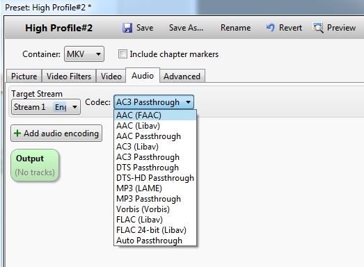

    But today I am facing converting a large high bitrate mkv file, with Dolby TrueHD, 7.1 audio. The audio file is even larger than a DTS file and I will need to convert it to my settings.
    My default choice for audio conversion, after trying others and getting poor results, is with AvsP/Avisynth. But I don't know any Avisynth plugin that will handle TrueHD 7.1. Is there one?
    As I will convert the large video file into a smaller size one, that will fit a DVD-DL capacity, I was thinking of also using Vidcoder for this conversion. But I'm not sure what choice to pick. What would suggest for 5.1 highest quality and best transparency?

    As far as I've used Vidcoder, there are just four choices for transcoding (i.e. NOT passing through the original) multichannel audio: AAC, AC3, Vorbis and FLAC.
    AC3 may the only one of those that doesn't offer 7.1 and I can't say if Vidcoder is able to downmix 7.1. to 5.1 correctly, but I would definitely give your proven audio format of AC3 5.1 640kbps and 48KHz a try and listen carefully to the results. My second choice would be AAC, but not if you still want your stuff to "play anywhere".

    OK. I'm giving the whole file a try with Vidcoder, audio and all, as we speak. Let's hope it does a fine job.
