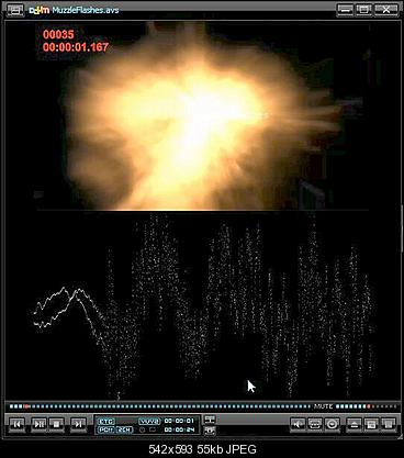

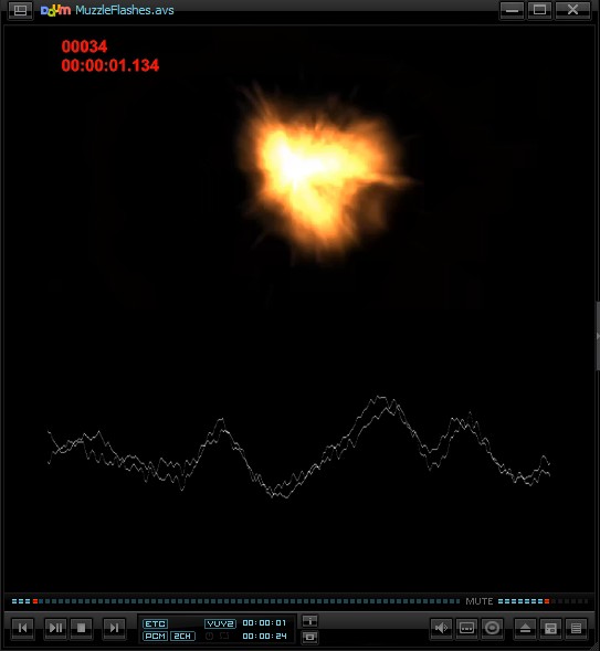

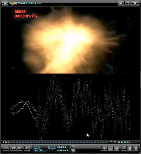

    If there is a sharp noise as mentioned above something like below should work. I'm not quite done perfecting it yet but soon.
Name:	ScreenHunter_22 Sep. 01 23.35.jpg
    Sound approximately 10 ms into 35th frame 43ms in length
Name:	ScreenHunter_23 Sep. 01 23.35.jpg
    The upper part with the timings is complete but the lower part has not been incorporated yet. Would something like this work?
