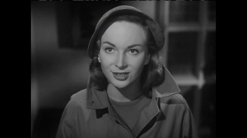

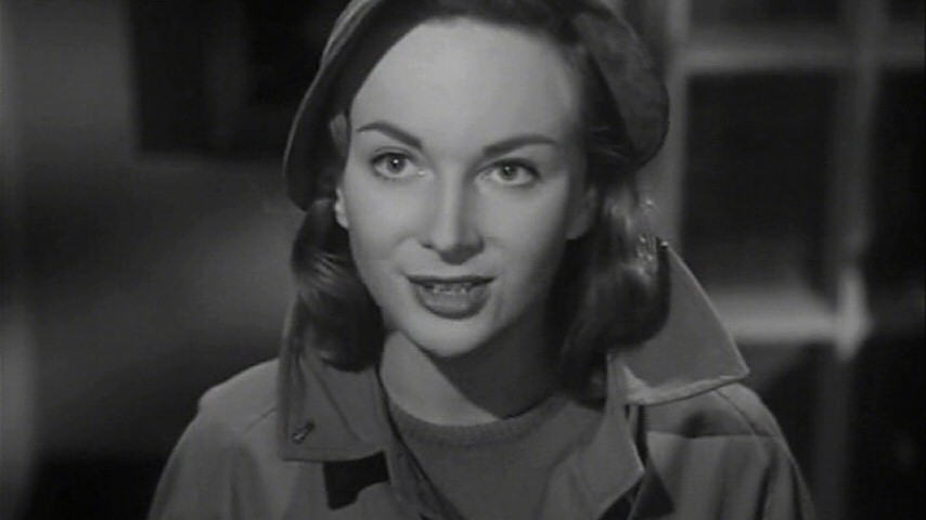

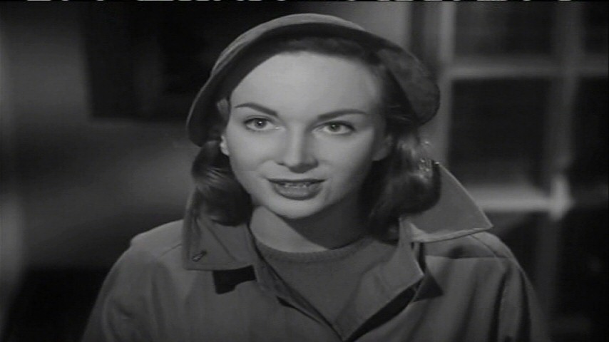

Name:	1333 example.jpg
Name:	1333 pillarboxed to 16x9.jpg
Name:	1333 stretched to16x9.jpg
Name:	1333 cropped to 16x9.jpg
    and there are still people that think #3 and #4 are best - heartbreaking

  13. Originally Posted by KBeee View Post
    So on non-HD channels on a widescreen, am I seeing #4?
    Aug 2006
    A standard definition channel broadcasting 4:3 material would normally look like #2 from the top on a 16:9 TV. It might be possible to see #4 from the top using one of the TV's "zoom" settings. You would see #3 from the top if you set the TV's "picture" or "size" to 16:9 using the remote control.
    Probably
    HD or SD doesn't matter - it's the aspect ratio that counts. 4:3 stretched to fill, or cropped to fill a 16:9 screen.
  16. Banned
    New York, US
    With a 4:3 original on HDTV wide screen, you're seeing #2.
    #1: 4:3 on a 4:3 TV, full screen.
    #2: 4:3 original seen undistorted on a wide screen TV at original aspect ratio.
    #3: 4:3 on a wide-screen TV, stretched to 16x9 and distorted horizontally.
    #4: 4:3 on a wide screen TV, enlarged to fill 16x9 (top and bottom of original are cropped off).

    Ah, but Olivia all stretched out? You calibrated your TV using ISF standard methods, of course, lest you miss out on all the fun. That issue of Robin Hood is one of the best transfers from classic-era Technicolor ever made, anywhere, anytime. But I would agree. It does lose something compared to a good print seen in a movie house. Unfortunately, digital video can't compare to film. The closest thing to original movie quality was a good, properly set up CRT. ANd that still wasn'rt as good as a decent movie house. Alas, LCD's are a poor third.
    As suggested earlier, your DVD player isn't set up correctly. Or, let's say, it's set up to correctly distort images the way you like them. They're your videos; video and tech forums won't tell you what to do, but I don't know of any video or tech forum that would advise you to do what you're doing. But I think you're really "watching your TV", not watching movies. Enjoy,anyway.

    DVD player is set to 16:9. Put a dvd called The Purple Plain in (standard format). The advertisement at the beginning is a for MGM films and shows in wide screen on TV (border on top and bottom) as does the poor quality warning short about pirating afterward. The movie itself fills screen top to bottom. There are 3 settings under HDMI and then wide screen on the DVD player itself 4:3 pillar box, super wide, and off. Setting it to 4:3 pillar shows in pillar but the picture looks very tall and compressed horizontally (tall skinny figures). Setting it to super wide causes blurring on the left and right side of the film, but no loss of vertical scene (I paused it on a scene with background stones so I could tell if the joints moved). Setting it to off cuts some of the picture left and right, but again not vertically - same seams between the background castle wall. DVD player is a Phillips DVP3560 which I like because I can play both NTSC and PAL.

    A DVD player should play 4:3 as 4:3 and 16:9 as 16:9. DVD encoding has only two aspect ratios: 4:3 or 16:9. Videos are encoded to play properly within those two output modes. Unfortunately many players don't automatically adjust to the source. A very common annoyance. It's best to leave TV's set to "auto" (they seem to be better at it than most players) and readjust just one component when needed, namely the player. But your wide angle edges shouldn't be out of focus. Something's amiss there.
