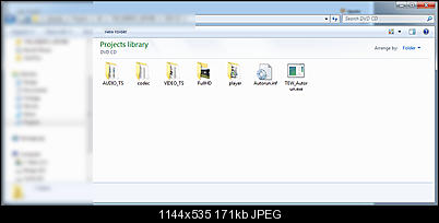

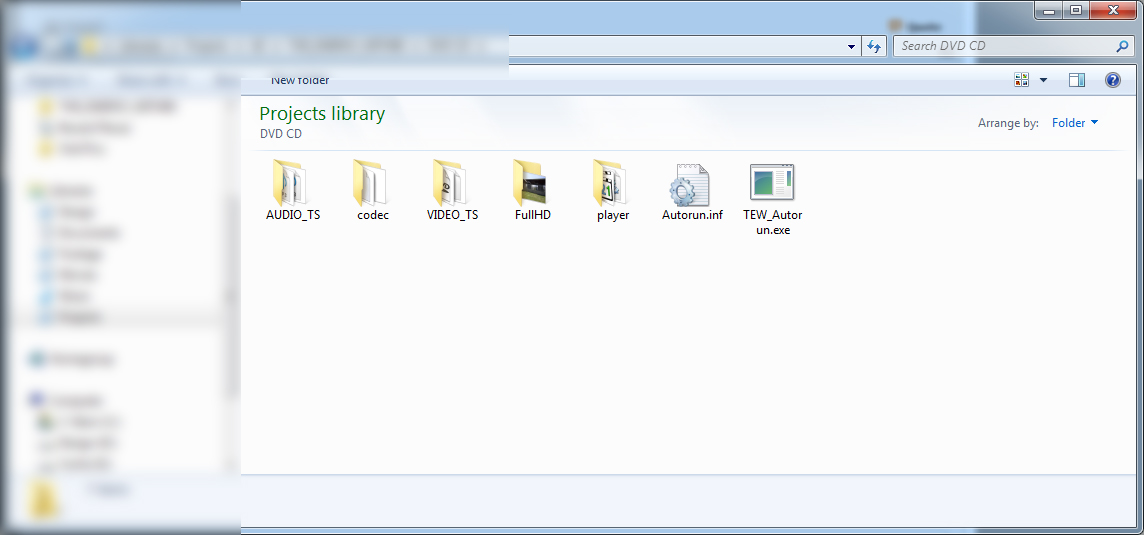

    The screenshot for the less-helpful guy:
    http://imageshack.com/a/img191/2144/ou59.jpg
    Inside the VIDEO_TS I have vob,ts,ifo,bup files
    inside the Audio_TS I put the hidden tracks (cause no-one sees that folder anyway)
    codec - self explanatory
    player - self explanatory
    FullHD - Contains the MP4
    PS. I'm all talking about from my own experience and research.

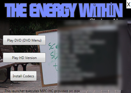

    The autorun:
    http://imageshack.com/scaled/large/837/2qpc.jpg
    You have the option to launch it using MPC-HC or launch it normally with the default player -.-"
    I'm not forcing anyone anything... how did you get to that?
  15. ok that's certainly better, but personally I'd known that I'd already at this point, seeing that screen, launched some exe file, I'd be pissed anyway ... and those codecs, , not sure about this ...
  16. if you're on Vista\7\8 it will ask you if you want to launch the autorun...
  17. ok, that's neat, ..., hopefully folks will not go for that codec installation for any reason, like having slow PC and thinking they need codec to play it better etc. I wouldn't put it there ...

    Mar 2008
    This is a good solution. Where does the screen come from that gives the user a choice to play the video?
    Is it contained within the autorun.inf, or does the exe file you have provide it?
  20. MPCHC has built in codecs so nobody should need to install any codecs. I'm sure the OP used AUTORUN.INF to run a little program that gives that menu of choices. I'd use VLC instead of MPCHC. It works better as a portable player.

  21. davexnet - read what jagabo wrote...
    I used autorun inf to run the exe,
    and jagabo - I just wasn't sure, in a tooltip on the button I wrote "if there are any problems" you know.. just in case...
    And personally I had too much hassle using VLC in my past, and it doesn't look cinematic enough for me,
    with MPC-HC, I run it with /fullscreen /play /close
    Then it really looks pro, and that's what I wanted...
