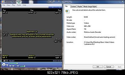

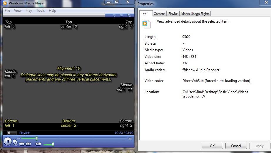

    If you have DirectVOBsub installed and the Video and Subtitles named the same, in the same folder (e.g. Video.FLV/ Video.srt) Media Player and Potplayer for sure will display the subs as a test. Just be sure if you have FFDshow installed and your codec is AVC that ffdshow isn't used to play the AVC format as it will stop the subtiles from showing. All other formats do not seem to care.
    Right clicking WMP while playing and selecting properties shows the DirectVOBSub as the automatic Video codec.:
Name:	ScreenHunter_22 Aug. 26 08.54.jpg
