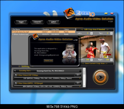

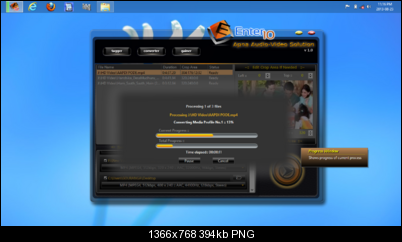

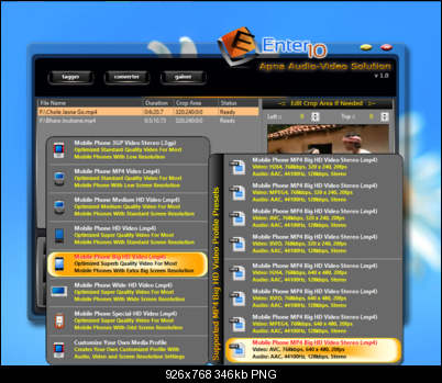

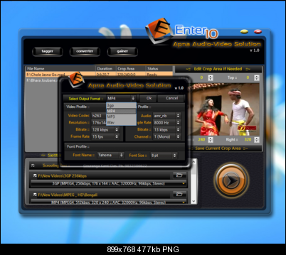

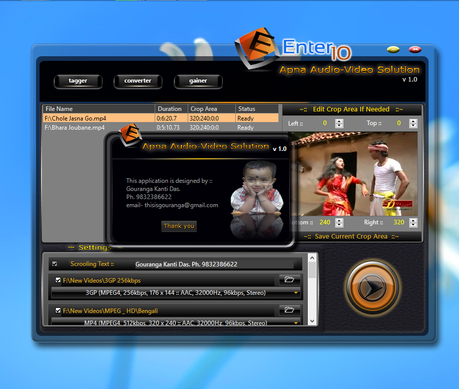

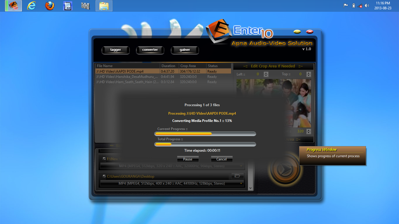

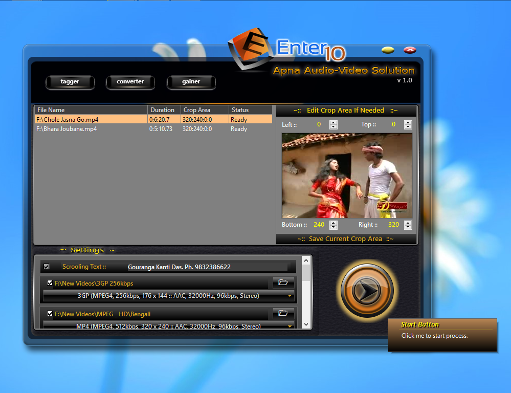

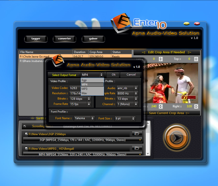

    Below, the screen shots are of my Simple GUI just as per my need.
ID:	19515Click image for larger version
ID:	19516Click image for larger version
ID:	19517Click image for larger version
ID:	19524Click image for larger version
