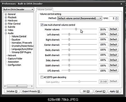

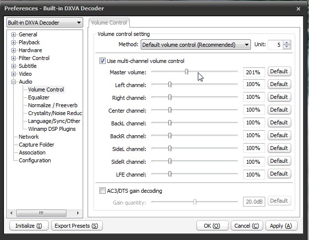

  8. Member Budman1's Avatar
    Jul 2012
    NORTHWEST ILLINOIS, USA
    If you adjust the Audio under preferences, moving the msster control slightly above 100% will increase the volume and has no effect on your systems master volume controls unless you select that setting at the top. Just play a video with pretty constant sound and adjust the Master volume, give it a couple seconds and the volume should increase or decrease as it plays.
