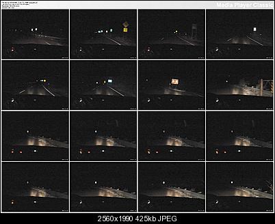

    - Converted one video I took at night with the fine settings (30fps)
    1st file (MOV09487_Color Fix_Only.avi - 1.58gb) , Ran this avs script, with no color conversion or no compression in VirtualDub
    vid = MPEG2Source("H:\My Videos\z Work In Progress\MOV09487.d2v")
    aud = WAVSource("H:\My Videos\z Work In Progress\MOV09487.wav")
    AudioDub(vid, aud)
    ColorYUV(gamma_y=150, cont_u=150, cont_v=150) # gamma and saturation stretch
    ColorYUV(levels="PC->TV")                     # a close alternate would be cont_y=-32
    return last                                   # <- Be sure to include this statement at the end!)
    Thumbnails
Name:	MOV09487_Color Fix_Only.avi_thumbs_[2013.09.08_19.49.01].jpg

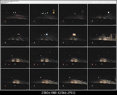

    2nd file (MOV09487_Color Fix_RGB_Vd_only.avi - 3.15gb) , Ran this avs script, with Virtualdub RGB(888) color conversion with no compression
    AudioDub(vid, aud)
    Thumbnails
Name:	MOV09487_Color Fix_RGB_Vd_only.avi_thumbs_[2013.09.08_19.49.30].jpg

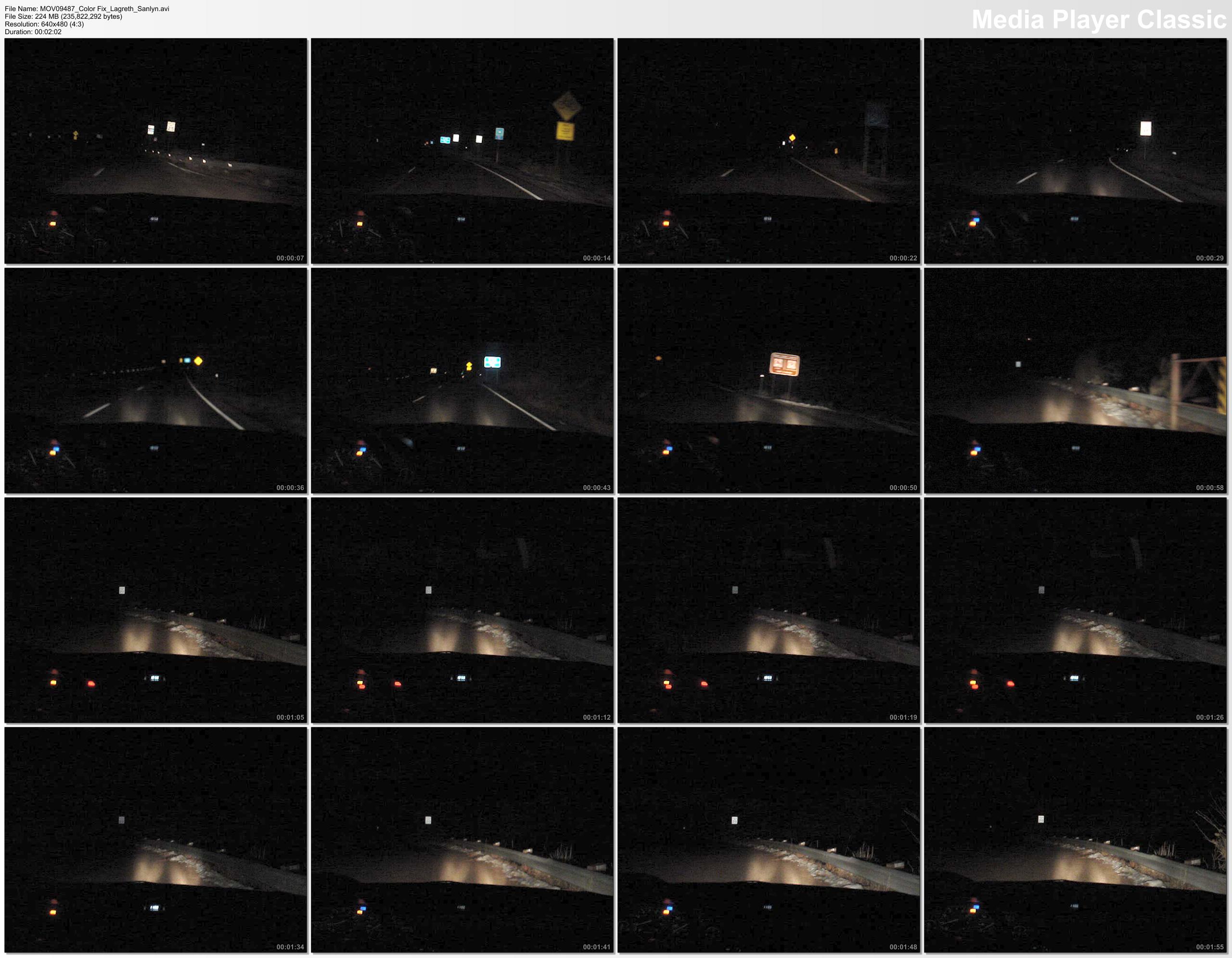

    3rd file (MOV09487_Color Fix_Lagreth_Sanlyn.avi - 224mb) , Ran this avs script, with Saylyn instructions, Lagreth compression in virtualdub only.
    AudioDub(vid, aud)
    Thumbnails
Name:	MOV09487_Color Fix_Lagreth_Sanlyn.avi_thumbs_[2013.09.08_19.50.03].jpg

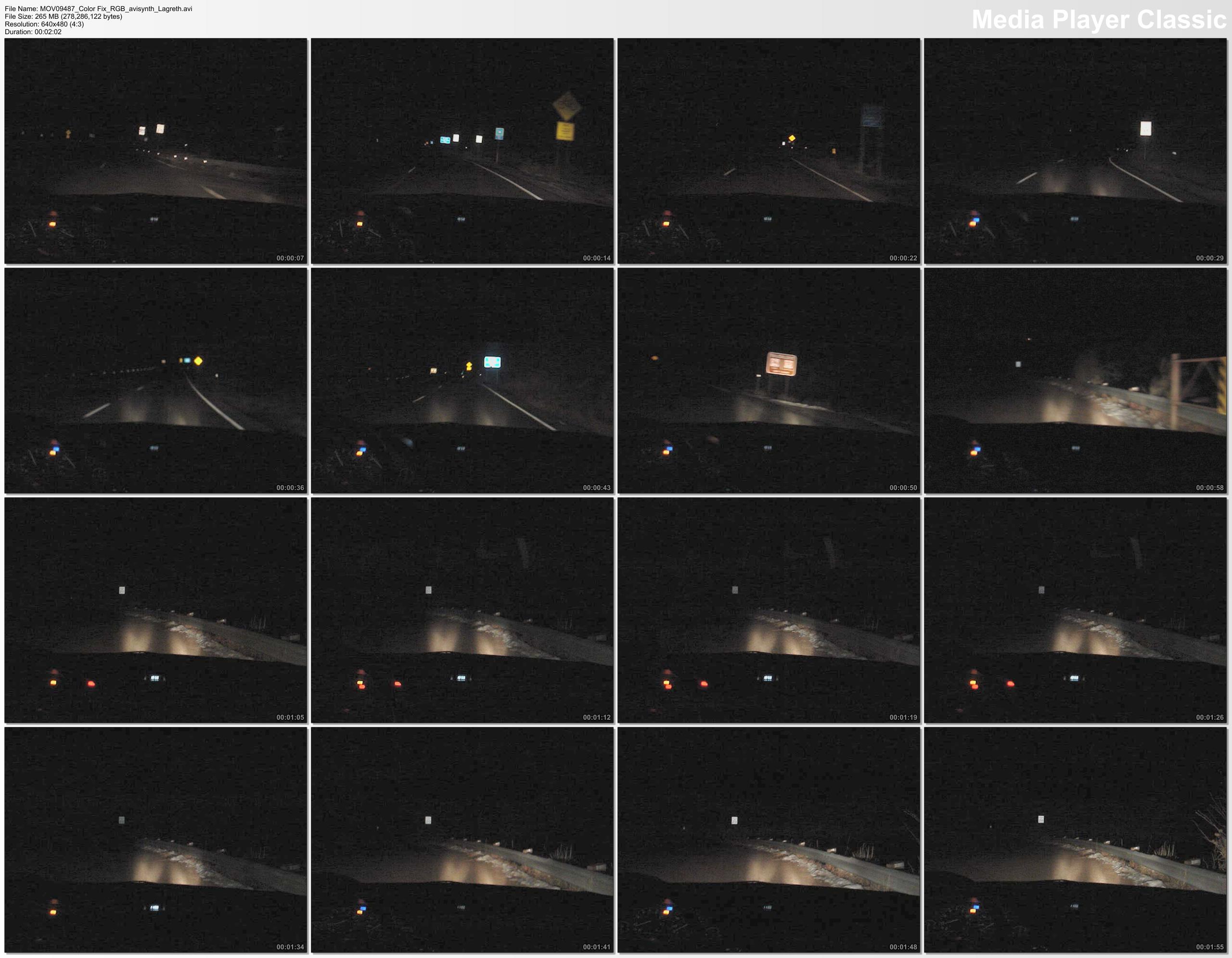

    5th file (MOV09487_Color Fix_RGB_avisynth_Lagreth.avi - 265mb) , Ran this avs scrypt, with lagreth compression set to RGB in virtualdub with no color change.
    AudioDub(vid, aud)
    ConvertToRGB32(matrix="PC.601",interlaced=false) #YUV to RGB
    Thumbnails
Name:	MOV09487_Color Fix_RGB_avisynth_Lagreth.avi_thumbs_[2013.09.08_19.51.13].jpg
