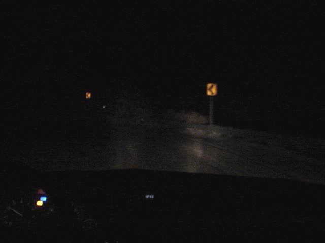

    I get mpeg-1 video from my camera Sony DSC-H1 but when i play it back on anything but the camera it looks too dark.
    When I change the Nvida Control Panel to make color adjustments with Nvida control panel and don't change anything it displays properly when played back on Zoom player and Media Player Classic 1.7.
    But when ever I encode or edit and save it and play it back again it loses its quality / brightness. I have not a clue how to fix it.
    On the left in zoomplayer is what it should look like, on the right is what happens when i encode it or don't have nvidia set to do the colors.
    MOV09497.MPG.MediaInfo.txt from Media Player Classic

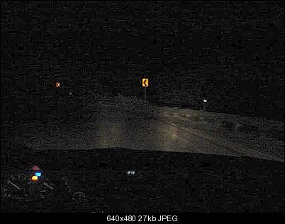

    As Sanlyn pointed out, your video is full of noise and has very little detail through most if it. But you can enhance what's there. It's also missing frames and has many duplicate frames.
    Mpeg2Source("MOV09497.d2v")
    ColorYUV(gamma_y=200, cont_u=200, cont_v=200) # gamma and saturation stretch
    ColorYUV(levels="PC->TV") # a close alternate would be cont_y=-32

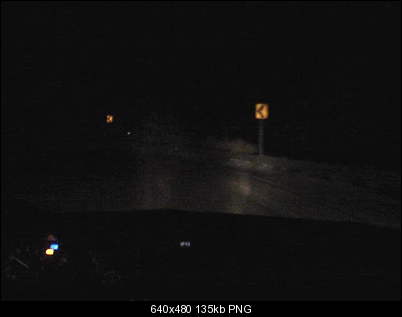

    i'd just increase brightness and contrast enough to make things visible and still have some semblance of black.

    Its a Sony DSC-H1 Camera, it a 5mp camera with 12x zoom. It will shot video, at 640x480 standard at 25fps and 640x480 fine at 30 fps. (not sure where I found this info on fps)
    It only gets 50min recording time with it set to Fine for video vs 3hr 3min on a 4gb memory stick.
    I'll see if I can find any footage that I recorded in fine. Have to go though and watch the night testing I did with my camera after Installed fog lights that I could run with my high beams on.
    Heres the Result I got with my video conversion. https://www.youtube.com/watch?v=JpF8KHlk6Zk Exported sound from original video as .wav cause using the .mpa file lost too much quality.
    Mpeg2Source("H:\My Videos\cvt_Videos\MOV09885.d2v") # run dgindex first for .dv2 and virtualdub for .wav
    ColorYUV(gamma_y=150, cont_u=150, cont_v=150) # gamma and saturation stretch

    The second part of the vid looks better than the original sample, but further conclusions aren't possible after the usual uTube treatment. I ran that script earlier and got fewer artifacts. But you did improve the exposure.
    Originally Posted by g6qwerty View Post
    Its a Sony DSC-H1 Camera...
    Thanks for the info. I figured a Digital SD camera. What happened to the frame rates? All the info I find says 16FPS in 3-hour mode. The low 2800 bitrate identifies 3.2-hour MPEG. There must have been intermediate processing (?): the 25FPS sample video looks re-encoded, has duplicate and periodic triplicate frames, jerky motion, severe macroblocking, mosquito noise, dct ringing + oversharpening artifacts, and pumped contrast. That's for starters. Even with low bits, MPEG shouldn't be that noisy. Surely it didn't come from the camera that way.
    @sanlyn how did you get that small mkv? I haven't started looking for a solution for that small file size yet. was going to check out handbrake.

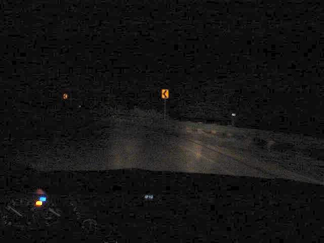

    Small? LOL, it's almost 70% bigger than the original sample mpg. Put it this way: high noise requires higher bitrates, mostly wasted on noise. After denoising I set a target of 4000 VBR (more bits would have been visibly cleaner). Less noise = lower bitrate required. But as I said, in many respects the effort yielded diminishing returns -- look at the disturbances every time something moves. But I suppose not much can be recovered from a low bitrate original. Encoded in h264 with TMPGenc Mastering Works 5. For MPG output, I would have had to jump to 6000 vbr or more.
    Filters used (mostly at fairly low or medium power):
    SmoothAdjust
    DeBlock_QED
    QTGMC (InputType=1, medium rep mode settings)
    NNEDI3 2X resize + RemoveGrain + Spline64Resize (anti-alias + restore size)
    Dfttest (16-bit dither version) + dither.avsi
    TTempSmooth + santiag + MaskTools2
    HQdering
    aWarpSharp2
    16-bit conversion YV12->RGB32
    NeatVideo
    ColorMill
    16-bit conversion RGB->YV12
    AddGrainC (anti-banding + make edges look smoother)
    Cleaned audio tone a little and resampled at 48KHz with Audacity
    I get tired just reading the list. I'm still surprised there was anything left to watch.

    Well that short clip of the video from the dark was from a longer clip that I cut SD, but one of the engine was filmed like that and came straight off of the camera SD too.
    Found 2, 640x480 fine video I shot, 2:02 min long and 152mb (Mov09487) and 5:46 and 432mb (Mov09488) It is at night how ever.
    Ran them both though Avisynth, DGindex and Virtualdub with the code I posted above I got a 3.15gb ffile for the 2min (Mov09487) one and 4.48gb file for 5min (Mov09488) because I set virtualdub to use same color space.
    Also Downloaded handbrake and just ran the files though it, first one (Mov09487) I did in .mp4 with custom 640x480 resolution and 22 quality all other settings default.
    Second one (5min)(Mov09488) as mkv with custom 640x480 resolution and 22 quality all other settings default.
    It actually looks like it improved the quality of the video for the (Mov09487) video
    And it is small because for that 30 sec video I have a 682mb avi file. double that size for the one uploaded to youtube.
    Here's the 2 videos that where Recorded in Fine mode.
