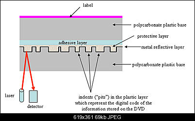

    A dvd has two polycarbonate layers, one is the carrier layer (thinker, stronger for handling), the second thinner layer is bonded to the thin metal layer ... this metal layer holds the data and is on one side of the disc ... not in between.
    On top of the thin metal layer is a dvds title art work ... but in your case they used sticky labels and it is this residue you are having issues with ... clean it off in the same manner and you should have no issues with this dvds for years.
    Nov 2003
    West Texas

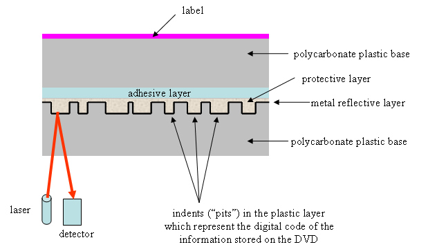

    The metal layer exists between the two polycarbonate layers. Yes, the metal layer is bonded to one of the polycarbonate layers, but just above the metal layer is the adhesive that holds the whole thing together.
Name:	dvd structure.jpg
