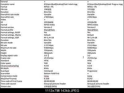

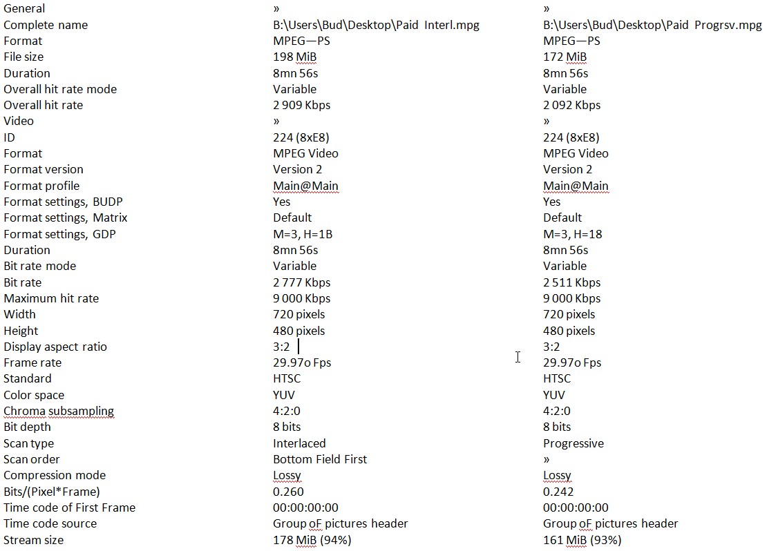

    DarrellS, Thanks for the better quality format script. I added it to my VDPROFs and reposted it at https://files.secureserver.net/0sou9GKxPLkcGw. I didn't see too much difference but it did correct my aspect settings. Also this will allow a Progressive (Yours) and an Interlaced version (Mine) in case users want to choose. The output is shown below for:
    Interlaced
    -f rawvideo -s %(width)x%(height) -r %(fpsnum)/%(fpsden) -i - -vcodec mpeg2video -target ntsc-dvd -bf 2 -b 8000k -dc 9 -flags +ilme+ildct -alternate_scan 1 -top 0 "%(tempvideofile)"
    Progressive
    -f rawvideo -s %(width)x%(height) -r %(fpsnum)/%(fpsden) -i - -vcodec mpeg2video -target ntsc-dvd -me_method epzs -threads 4 -g 45 -b 5800k -bf 2 -trellis 2 -cmp 2 -subcmp 2 "%(tempvideofile)"
Name:	ScreenHunter_21 Aug. 23 10.07.jpg
    Thanks again to DarrellS for your settings.
