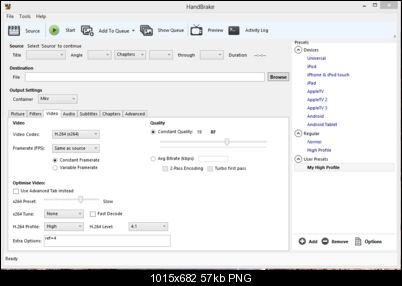

  11. Member thefinalprophecy's Avatar
    Apr 2004
    Yeah that's basically the same that I have too. I'm not new to video encoding (registered here in 2004 apparently!) but I can not figure this Handbrake framerate issue out! And the people on the Handbrake forums are basically telling me "it doesn't matter, it plays no matter what" lol. Call it OCD, but it matters to me!
Name:	Screen Shot 2013-08-20 at 3.27.31 PM.png

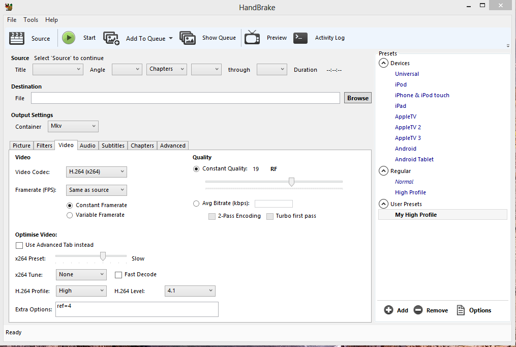

    Nov 2003
    West Texas
    Try these exact settings and do a small test encode by choosing one of the Preview selections.
Name:	Handbrake settings.PNG
  13. Member thefinalprophecy's Avatar
    Apr 2004
    Ok trying that now. The only thing different really is the ref=4. What does that flag signify anyway, something about reference frames?
    Nov 2003
    West Texas
    Yes. If you don't add it with this configuration, it will output with 5 references frames. Not a big deal, but 1080p video is supposed to have a limit of 4 reference frames at Level 4.1. 720p can have a lot more.

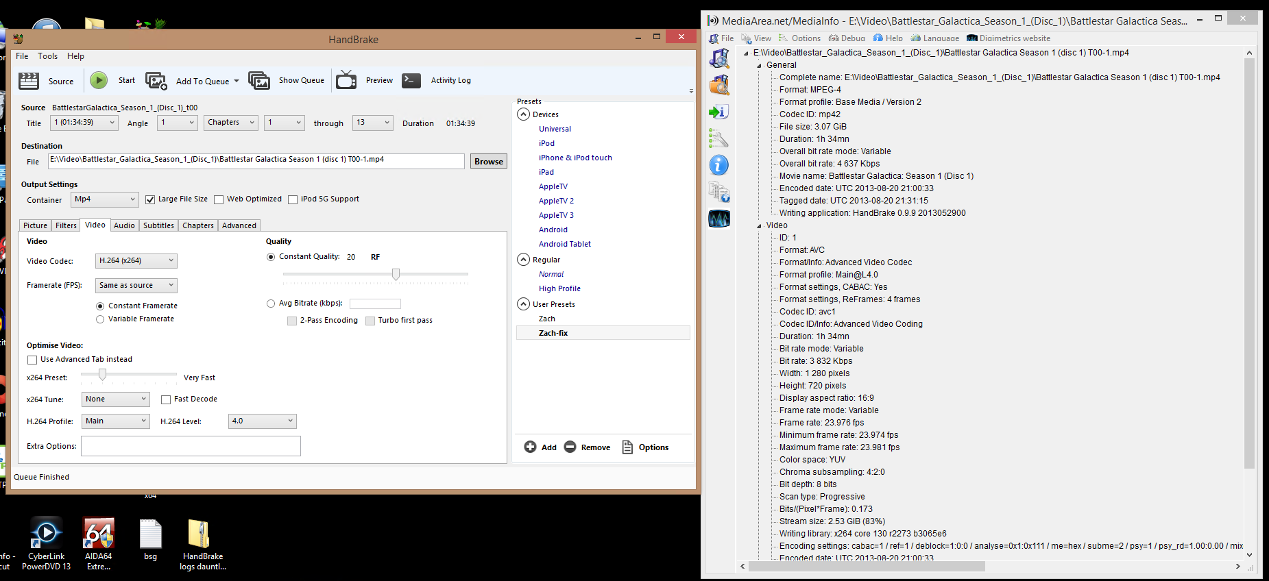

  18. Member thefinalprophecy's Avatar
    Apr 2004
    Originally Posted by Kerry56 View Post
    That's weird. Shouldn't get different results using the same program with the same settings. Here is a test clip using those settings:
    [Attachment 19465 - Click to enlarge]
    I agree, very weird! Feel free to try it out for yourself using my same videos. I cropped a 1 minute segment from my source MKV using Boilsoft Video Splitter to do a direct split--no reencode. The second file is after converting in Handbrake using the High Profile preset, changing resolution to be 1280x720 and changing VFR to CFR (Same as source). Nothing else has been changed and this is a vanilla Handbrake install. See if you come up with the same results.
    https://dl.dropboxusercontent.com/u/23922163/Battlestar_Galactica_Season_2_%28Disc_4%2...00s%29-002.mkv
    https://dl.dropboxusercontent.com/u/23922163/Battlestar_Galactica_Season_2_%28Disc_4%2...ighprofile.mp4

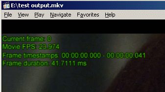

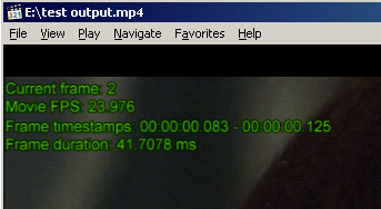

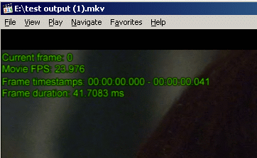

  28. It's still have a feeling it's something to do with the first couple of frames, but I've no idea what. I discovered, when playing the original MP4 and the remuxed MKV with MPC-HC, and while using ffdshow's on screen display to have a look-see, the original MP4 sample actually starts playing at frame number 2, according to ffdshow, and as that's frame zero for the remxued MKV, they're two frames apart from start to finish. So maybe it depends on WTF is really going on with those first two frames and how the frame rate is calculated, because according to ffdshow, the rest of it is CFR from start to finish.
    Here's how MPC-HC/ffdshow displays the first frame of the MP4 version:
    Name:  mp4 first frame.gif
    Now after remuxing it as an MKV without specifying a frame rate:
    Name:  mkv original frame rate.gif
    After remuxing it as an MKV while specifying a frame rate (23.976):
    Name:  mkv 24fps.gif
    What's also a little strange is when I remuxed without specifying a frame rate, the output MKV seemed to inherit a little of the original MP4's "oddness".
    ffdshow displays the frame rate as 23.974 instead of 23.976, and it displays a slightly different frame duration accordingly, but.... it's wrong. I'm not sure I've ever seen ffdshow get it wrong like that before, but if I skip to the last frame and look at the timestamp, it's 00:59:683 both times, so the frame rates must be the same. And to confirm that, I extracted the timecodes from each MKV and they were identical.
    PS Well it turns out the first frame oddness was being caused by MPC-HC's internal MP4 splitter. When I switched to Haali, the first frame went back to being frame zero instead of frame two, but I still suspect there's something odd going on there. Trying to work out what though.... I might give up.
