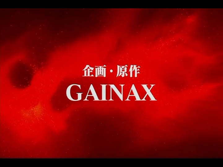

  1. Hey all, just found this place and so far everything has been very informative, but there is something i cant figure out. I'm still pretty new at all this though so bear with me. Here's the situation... I have .mkv rips of an anime that VLC and Handbrake says are 704x480, but upon further inspection are actually 704x528 (4:3)... When re-encoding them in Handbrake, no matter the settings, it flattens it to an actual 704x480 (22:15 or something) resolution, resulting in a squashed image.
    Original:

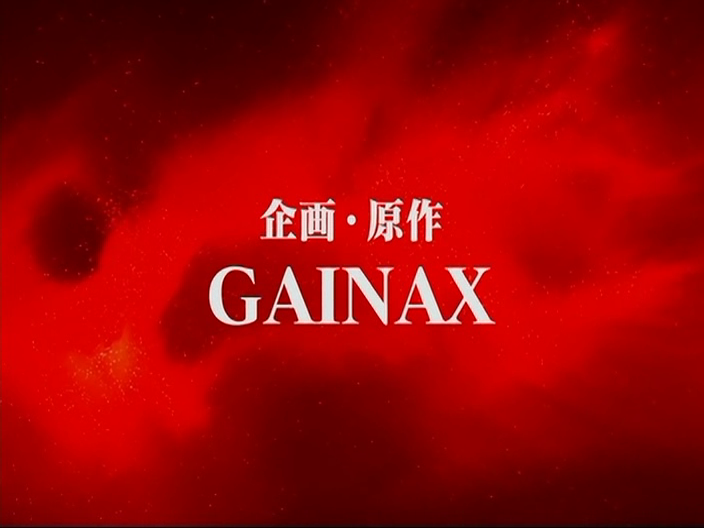

    After Handbrake:
    But the interesting thing is, if i force 4:3 aspect ratio in VLC it looks correct... any idea whats going on? also

    Media Info says 704x480... then how come it gets flattened when processed by handbrake if its resolution stays the same?

  4. The original was probably encoded as anamorphic, non-square pixels.

    I said 'the DAR set as 4:3'. DVD has two and only two DARs (Display Aspect Ratios), 4:3 and 16:9. Both original resolutions might be 720x480 (for example) but the DAR tells the player how it's to be shown during playback. For yours you want 4:3 and then it'll look the way it should during playback.
    As blud7 said, the 'source' had a setting in it that told the player to resize it properly (to the 704x528 you thought it was). When reencoding in Handbrake you never set that flag and so it plays as 1:1 (flat) rather than being resized properly. Don't blame Handbrake. But that's still no reason to use it to make an intermediate file on the way to making a DVD.
