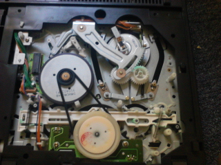

  18. It's still rattling but nothing is falling out. If you want I can post pictures of the inside.
  19. I'm a Super Moderator johns0's Avatar
    canada
    Ya,post a pic.
  20. I can post a picture of the top now, the bottom will have to wait until tomorrow.
  21. Okay here it is
  22. I do hope it posted...
  23. I'm a Super Moderator johns0's Avatar
    canada
    Can you post a pic of the bottom of the vcr in higher resolution,can't see anything from the top except that the left guide isn't at the top where it should be.

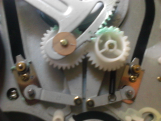

  27. Okay here is a picture of the bottom
    Image Attached Images
  28. I'm a Super Moderator johns0's Avatar
    canada
    Can you take a picture of the vcr from the top with the video cassette totally removed?
  29. Well, I found the part that was rattling around, it was a tiny bit of plastic that looks like it came from a gear. I also noticed a spring that is not really connected to anything... so I know where that part came from, but I don't think I can take the gears off.
