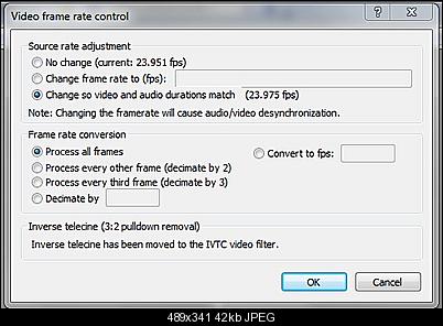

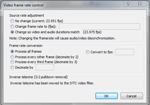

    I don't know if you are aware or not, but since you are already using VirtualDub, did you know there is a setting under Video -> Framerate that fixes a lot of sync problems due to the situation you are mentioning? Just check adjust so frame rates match and often you will see the rates are different and can be corrected here; See the example below and notice the slight difference due to different length audio and video.
Name:	ScreenHunter_22 Aug. 25 11.01.jpg
    Just FYI, it might fix your problem with less encoding
  12. Originally Posted by Budman1 View Post
    [Attachment 19598 - Click to enlarge]
    Yes I was aware of that and I did use Vdub to change the sync without encoding. I'm just wondering if there's some alternative tool to extract the video from the flv without the pixelation at the borders.
