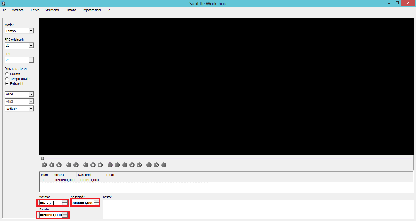

  1. The text in the columns appears correctly. I'm referring to the box... When I click inside to edit the time...

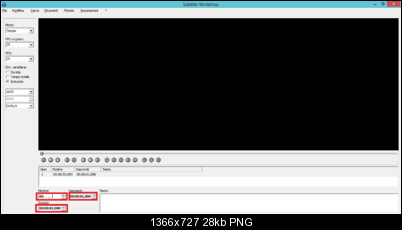

  2. Originally Posted by Frank619 View Post
    [Attachment 19908 - Click to enlarge]
    That's really strange.
    Try the new Subtitle Workshop 6, check if the same happens.
    Subtitle Workshop 6 now available!
    http://subworkshop.sf.net
  3. Same problem... I've tried with Subtitle Workshop 4 and it works properly... but I don't like that version
  4. Originally Posted by Frank619 View Post
    Really, really strange.
    Can you please answer the following questions:
    1. Does it only happen for Hide and Show, or for the Duration and Pause boxes as well?
    2. What happens if you simply use the arrows to modify the values?
    3. What happens if you use the mouse wheel (without clicking inside the boxes) to modify the values?
    4. Also, give me other examples with other values like this one:
    Show
    [00:03:05:625] -----> once I click inside, that's what appears [25. . , ]
    Does it always turn exactly to [25. . , ] or is this 25 the last two numbers of the actual value?
    5. What happens when you exit the box that has the value [25. . , ]? Is the original value restored or does it change to something?
  5. 1. For each box in time mode, if I select frame mode everything works fine
    2. If I use the arrows I can modify the values... [just +100 ms or -100] so I can't edit them properly...
    For example:
    1 00:00:23,702 00:00:25,927 +
    2 00:00:25,958 00:00:27,633
    If I simply use the arrows to increase the value (hide value, first line) I can't get what I want
    1 00:00:23,702 00:00:25,927 + Once I click ------> 1 00:00:23,702 00:00:26,027
    but I wish it was -----> 1 00:00:23,702 00:00:25,958
    3. No effect.
    4. This 25 are the last two numbers of the actual value. If I copy this strange value [25. . , ] and then I paste it to notepad, I get the original value [00:03:05:625]
    5. The original value is restored.
    The only solution is the following at the moment, for me:
    I click inside the box to modify the values, then I delete its content and I write the entire correct value and after I press enter... but this is a boring and slow process.

  7. Originally Posted by Frank619 View Post
    3. No effect.
    Is that for Subtitle Workshop 6 or 2.51?
    And one more question - what happens if you enter a time box not by clicking on it, but by using the TAB key?
  8. Both version.
    Just like clicking on it, same effect.
