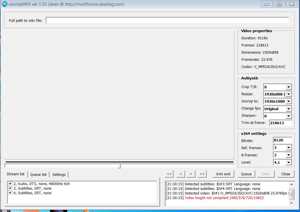

    Baldrick, I tried uncropmkv as you suggested, but it would not run. As seen in attached screen print, it would not accept the 808 height resolution.
    Can you please suggest alternative software?
    Jill

    Uncropmkv is accepting it,it is resizing it properly,its just an initial message that the original size isn't compliant.
    Nov 2003
    West Texas
    In other words, click on Queue, then Start.

    thanks for this information. This is the first time I have used uncropmkv, and there is no help file and I can't find anything on how it works. Please bear with me as a newbie to this
    After I pressed queue and Start, I end up with an unreadable file with .264 at the end of the name, with zero kB file size. uncrop-mkv indicated it was "Done!", although at the beginning of the process of loading the mkv file I get the message avsinfo.exe had stopped working.
    Can anyone please point me in the right direction as to what next to do?

    Install ffdshow and avisynth 2.58 and haali media splitter if you haven't already done that and then use uncropmkv.Also do some reading on encoding concerning mkv and other types of files.

    hi, I loaded the software described by johns0, and it ran beautifully, resulting in an uncropped_mkv file with the correct resolution ( 1920 x 1080) and a .264 file. Thanks for that
