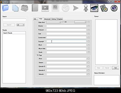

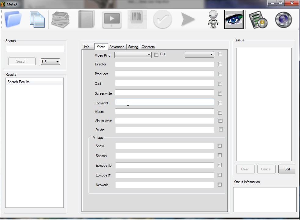

  6. Member Budman1's Avatar
    Jul 2012
    NORTHWEST ILLINOIS, USA
    MetaX isn't free but at $9.99 is will do what you want and even download cover art if you choose.

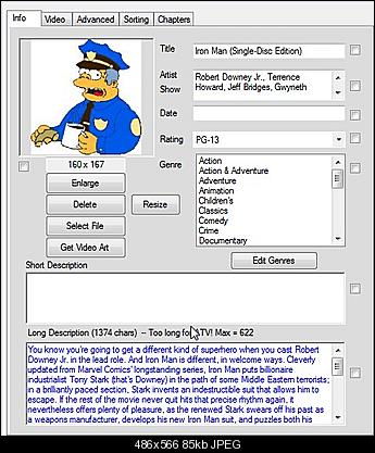

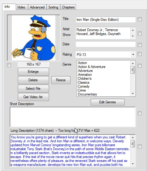

    And no this is not an illegal IronMan copy. It was a short MP4 segment that I worked with the author because after editing certain MP4's, they would not play without using a hex editor to correct. Hence the Cover art character.
